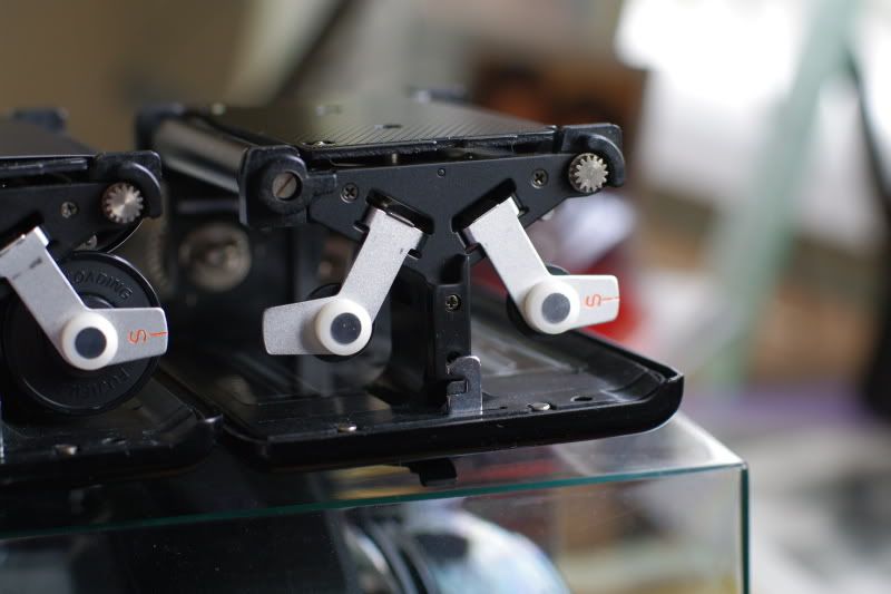

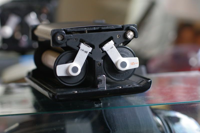

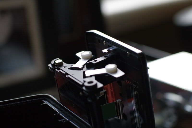

Hey folks, hope you don't mind me bumping this thread.
I just bought a 220 insert because they're going for SO much cheaper than 120 inserts... but now, nobody carries 220 film and ordering online to Canada is PROHIBITIVELY expensive!!!
So, I did this modification so I can use all my 220 inserts in 120 insert mode and just wanted to verify that people can confirm that there are no long term issues with this mod? Essentially, you buy either 120 or 220 insert and you can just switch it up depending on the way this black piece is directed?
Here are some images!
A shot of the black piece in question:
This insert is set to 220:
This insert is set to 120:

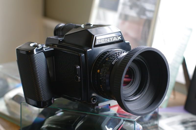

And obligatory shot of my Pentax 645!
