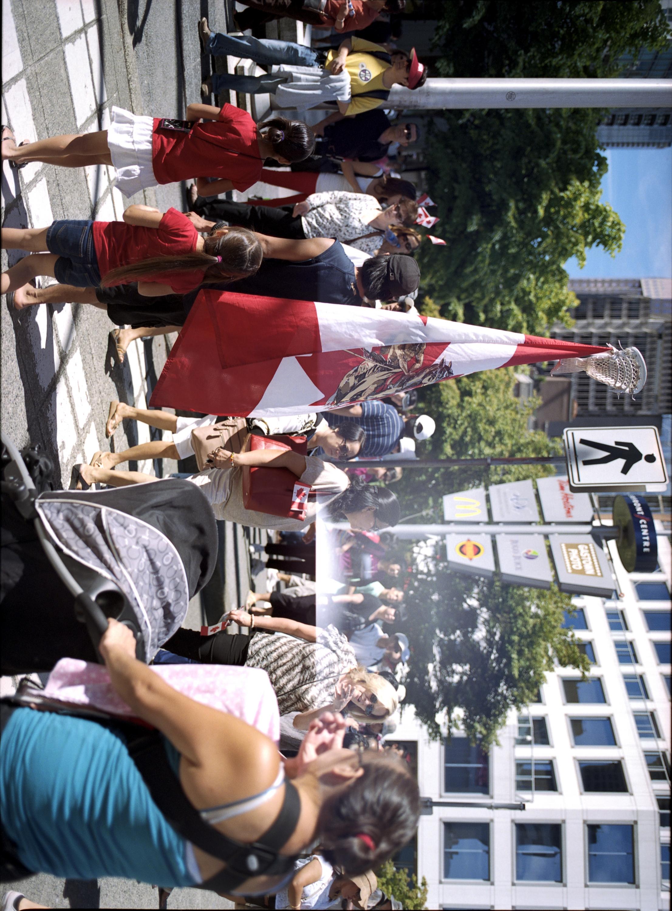

Recently, I've been shooting with my Pentax 645 and have seen a few frames with light leaks that show up halfway through the frame. It's a bit disconcerting as it's happening to not one of my Pentax 645s but to my other one also (my backup).
Curious if you folks have run into this and ... maybe it's the insert??
*EDIT: It happens every few frames, not on every single frame...

Certainly sounds odd. Could it be possible that the film may have had some exposure to very bright light before loading it? As I am sure you are aware, unlike 35mm, 120 is not completely light tight, particularly if the wrap is a bit loose, before you load it or after it has been exposed.

Now, I don't have a 645, but I have a Spotmatic that had that same problem.
It isn't actually light leaks in the strictest sense. It is something else. On the Spotmatic it could be unwanted reflexes from the focusing screen due to a light seal deterioration.
It could also be a shutter problem if the 645 has a vertical travelling shutter. In that case it only happens at certain speeds and that's why it only occurs in some frames.
Check the light seals around the focusing screen and the shutter.
That is at least a start.
Possibly, but then I suspect that the leak wouldn't be so uniform? It's always down the middle all the time when it happens (just like in the photo).
this is what I'm starting to suspect. It could be the shutter... or the light seals? Hmm....light seals seem OK. If it's the shutter, I'm thinking this might be an expensive repair... or opportunity to be a 645N or NII.

Hmm... it might relate to the film insert. That being said, I switched film inserts on this camera and (just to confuse things more) also switched camera... so it's either another bad back or faulty camera ... or both. ... I will have to grab a test roll or two and just try different combinations out to narrow down the results.
I have 3 inserts and 2 P645's.
1 good insert + Good 645 (as far as I can tell - will be taking for a spin today as a wedding guest. Used on a recent shoot and it was fine)
1 leaking insert
1 questionable insert + Dodgy 645?
That being said, curious if others have ran into this issue and what the fault was?

I had light leaks issues with my 645. And I tried changing the light seals. It didn't fix the problem. But taking great care when I remove the exposed film helped.
This problem first showed up when I switched to Fomapan film (I do like the film, but not the hard, stiff backing paper). The film seems to want to unfold
when I take it out. I now open the back slowly, and press a finger on the roll as fast as I can before removing the back. I try to do this in dim light also.
To sum up, the problem was the filmchange not camera lightleaks.

I can see that being the case if the images had light leaks that were very random, but these appear to be uniform (a straight line plus a leakage area on top of it in the same spot on the negatives that are affected... see the attachment).
But thanks for the suggestion. You could be right.

The reason I mentioned this early on is that I experienced a light pattern similar to your own. It was not from my 645 but actually came from one of my folders. After a lot of unnecessary troubleshooting I found that the light leakage went away if I unloaded in the darkroom and tightened the roll after it came out of the camera. There was nothing wrong with the camera with the only exception being that it did not roll the film tight enough. The arm that exerted pressure on the feed roll did not do a good job of keeping that pressure even as I advanced the film. The film and paper were slightly loose on one side of the roll allowing light in. The light did not affect all the negatives, only a few that were on that side.
As you say, it probably has nothing to do with it. But it is pretty easy to fix. If the exposed roll feels a bit spongy when you remove it from the camera it could be loose enough to let light in at different locations on the roll.

Thanks, Pioneer. I'm starting to get convinced it could be my unloading the roll in broad daylight and perhaps night tightening it enough. Hmm... how does one counteract this?

I believe there is 1000 answers (at least), but I can start counting:
1. That's 120 film! Not quite safe always.
2. Black plastic bag. Darkroom changing bag (I know, not a good suggestion). Hide in shadows.
3. Film backing paper and the film itself acts different. As I said in an earlier post, this problem startet when I switched to Fomapan film.
I, and many others I believe, have seen this with Shanghai film. They both uses a stiff, heavy backing paper. Sometimes not quite straight at the ends, some sort of curly, or how shall I tell it? (Sorry, my English is not as good as my Norwegian).
I have never observed this with Kodak or Ilford films, and they use a very thin, smooth plastic like backing paper.
and so on.
I do struggle with this type of problems still, so I have no intention of telling any solutions to this problem. But this is some of my thinking and what I have tried and continue to try.
I'm anyway still convinced my problems is the film, not the camera.

So, based on reading this thread and all your thoughts, I took a bit more care to cover and fold up my 120 film in shaded areas and TIGHTLY winding it. Unloading takes place in a darker area.
I've used two different inserts in a camera and so far, the images have been very good. No issues.
You all may be right. Think it might be user error: mine.
