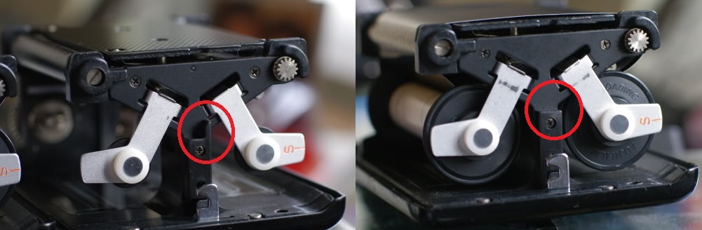

On the left the back is set for 220 and on the right for 120 films.

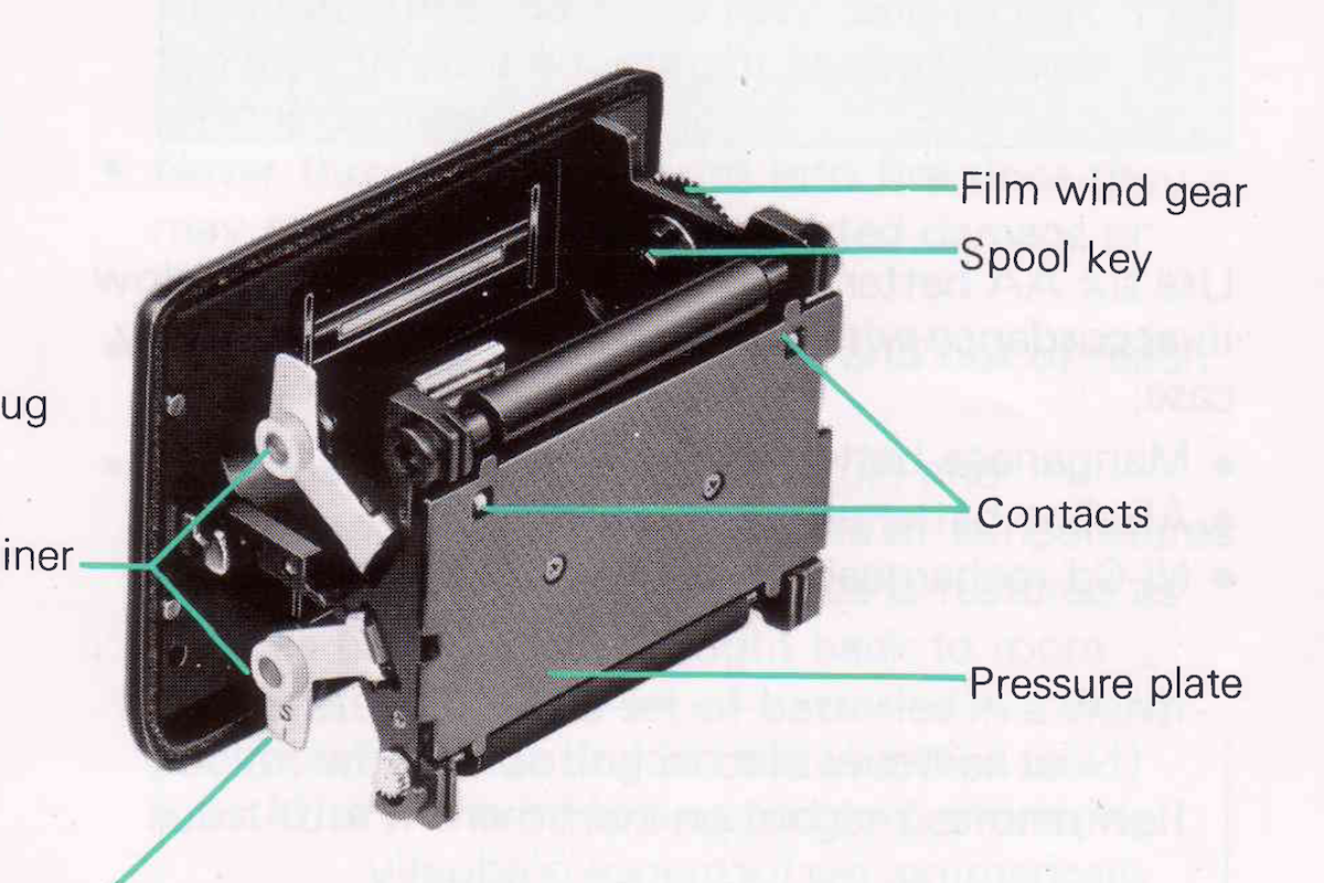

It's been several years since I've own a P645, but I believe there are 2 electrical contacts on the left side of the insert that tell the camera that there is film loaded, which is sensed by those feelers that stick out through the pressure plate..

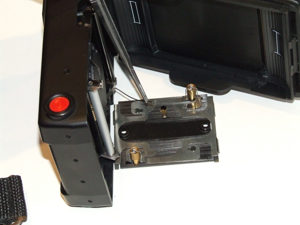

The thread linked was supposed to be about this repair of a Rollei 6008 film back that would not wind up after the last shot. This wire to the film sensor had come loose. After re-connecting, it has worked flawlessly.

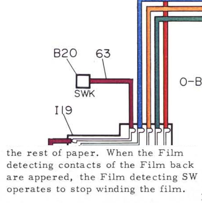

The Pentax 645 manual seems to indicate "B20" is the film sensor switch with wire "63" attached.
This is when loading the film I suppose, not when 15 frames have been shot.
Btw I didn't selected the right photo I had in mind. Correct is : 120 is on the left and 220 on the right.
