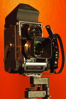

I have one that came with my C3, I much prefer the WLF for normal use. The prism does add some weight to an already heavy camera, I think the C3 weighs more than the C330, more metal. One advantage of the prism is fine focusing is easier for me. For me the disadvantage is having to hold the camera up to my face, I think the wlf is more ergonomic shooting handheld. If you're using a tripod most of the time then the prism may be the way to go. I think there are lighter weight prisms than my all metal one.
Mamiya C3 by Bryan Chernick, on Flickr
