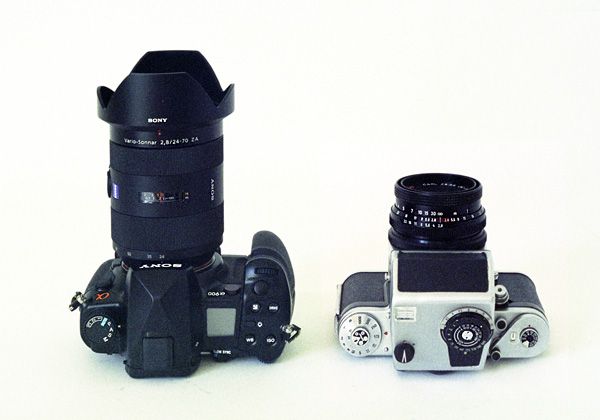

I notice that often it is repeated like a meme that the P6 is huge. The Brit who keeps an english site pentaconsix.com puts side by side a P6 and a FF 35mm DSLR the Sony A900, this gives a good idea, people who want to buy online without possibility to hold it before can have a feeling:

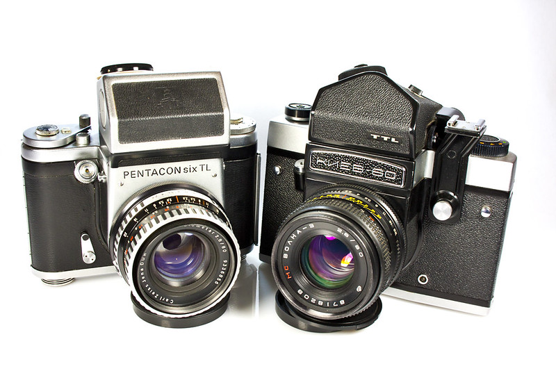

so, I don't have a P6 at hands to show size, but this gives an idea, the Kiev is almost same:
