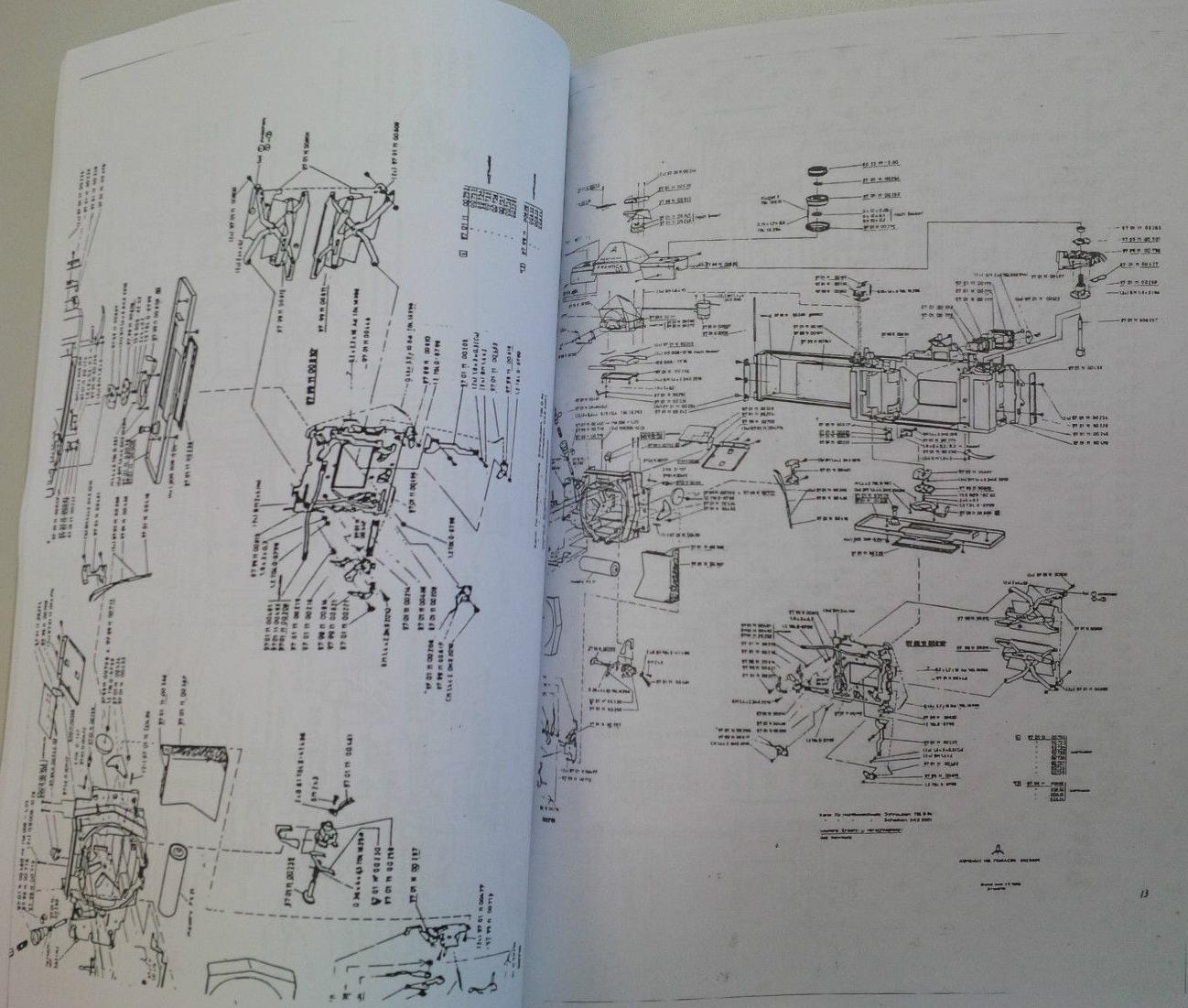

You could lubricate the shutter delay mechanism without removing it. The issue is that the lubricant might seep where you don't want it to go. There are 2 or 3 flat head screws that attach the mechanism to the chassis. The mechanism surrounds the shutter speed shaft. The film counter mechanism has to be removed first. When the counter dial is replaced, one has to wind it up. I have an exploded diagram that I will upload. I also have the German language service manual that I can send to you if you will send me your email. It is 17 M. Chuck
