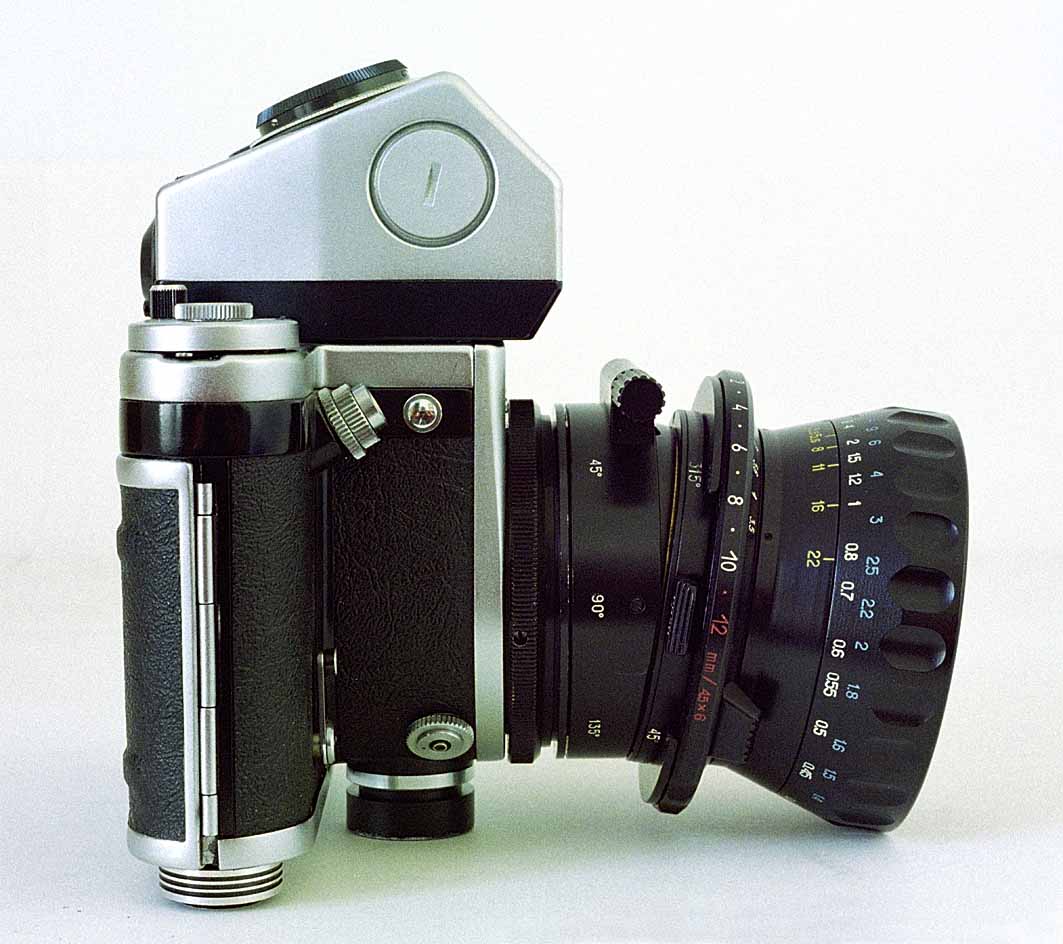

Is anybody aware if such a lens exists and what it is called. Do they come in various focal lengths? I am thinking of buying a Penatoc Six and would like to take advantage of the focal plane shutter (since my Bronica can not accomodate a Tilt/Shift) to control selective focus. Any help appreciated! Rgds, kal

The Hartblei Super-Rotator 45mm Tilt/Shift lens

;-)))) Perrfect on the Hartblei. Can anyone please advise on the experience of the film transport mentioned by David? Kal

They often develop overlapping frame problems. Mine was very touchy in this regard.
Hartblei does a number of conversions like this in different mounts. They make the adapter for Hasselblad lenses for 35mm camera bodies that Zeiss markets.

Apart from the Super Rotator shown, there are some other lens options. Take a look on the Arax site.

Hmmm apparently Hartblei do not do the super rotator anymore. Looks like Arax is the only choice...does anyone know whether the tilt-shift would work with a 2x teleconverter? Would it effectively become a 90mm f7 Tilt Shift lens or would it behave differently....K
