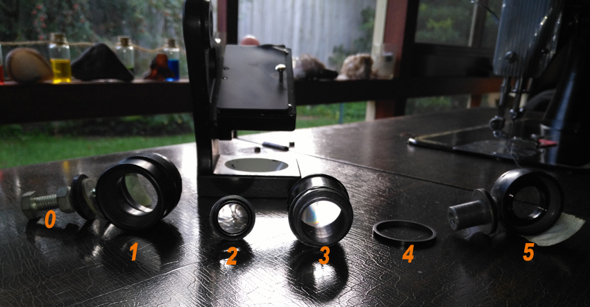

Hi guys,
Would anybody happen to have dimensional drawings for this model or possibly tell me the OD of the eyepiece? Also is the eyepiece able to be disassembled or swapped?
Many thanks,
C
(Please ignore evidence of my Peak's dark and sordid past!)

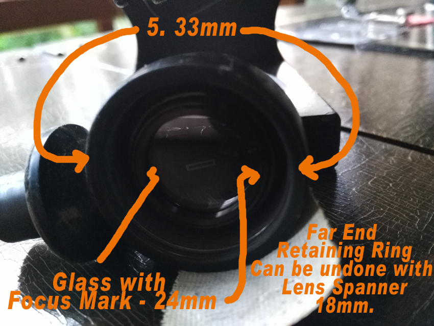

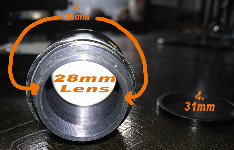

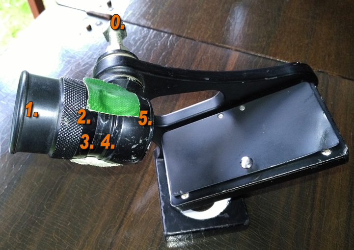

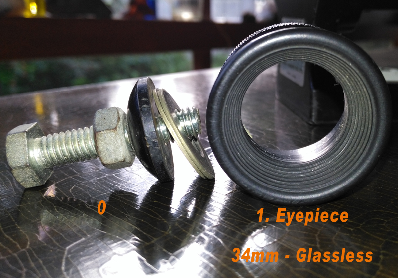

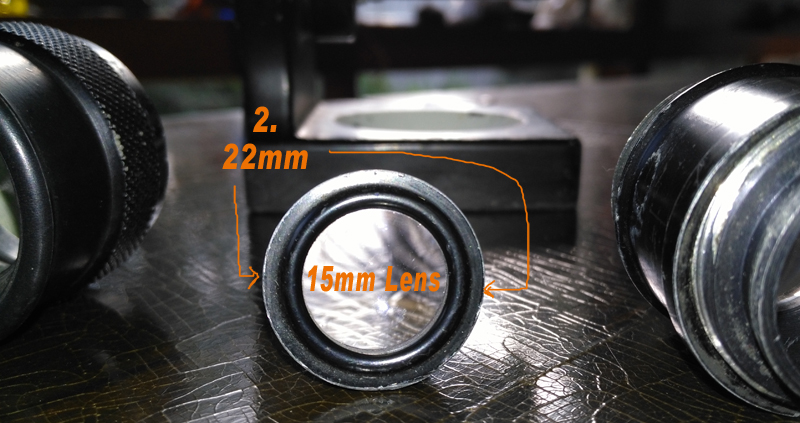

In the realms of [probably] too much information....
Is any of this of any help at all? All measurements are the diameter across to the outer edges in millimetres (Circumference = Multiply by pi ((pi = 3.14159))
0a Peak I.jpg 0b Peak I.jpg 1 Peak I.jpg 2 Peak I.jpg 3 and 4 Peak I.jpg 5 Peak I.jpg
Looks like 34.5 mm
Thanks!
I have the Micromega Koana one if that is the same. And a pair of machinist calipers..... If Pieter12's answer isn't what you are looking for. Be specific.
Was just after some nominal dimensions, looks it is a bit bigger than I was hoping so I will have to machine something up. Precision measurements would be nice, aside from the different branding there seems to be some minor variations of the eye piece namely the knurling style, and filter slot. The one without a slot has a slight lip on the edge.

I appreciate the images, this gives me confidence I can easily take it apart and make new parts if required. Looks like the lipped version, the one with the filter slot has no lip.

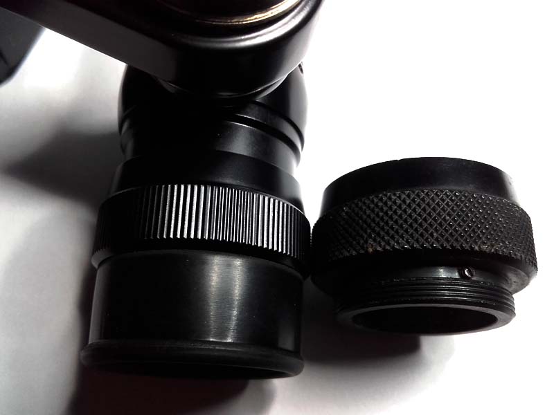

Peak Vs Micromega knurling.
Here is a micromega version with a filter slot, the green is the OD dimension I require. Would I be correct in saying this is an earlier model with a slot and the newer ones appear to have a push on filter? Is the top lip portion rubberised - seems there is a small split line there..
