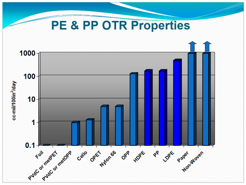

He said unless leaving the developer a very very long time the difference in oxidation between PE and PET is so little that it would not matter even for chemicals that are a lot more sensitive to oxidation. He said it is inevitable to not leave a little air on top when closing and that air is a lot more than what the PE will let in over double digit years.
Don't agree with your chemical engineer. See graph below for OTR (oxygen transmission rate)
Screenshot 2023-01-29 at 16-39-44 Microsoft PowerPoint - 1.2 K. Frey Polyethylene and Polyprop...png
Values are in cc-mil/100in²/day. Non-standard, but convenient units. Such that if you multiply by the barrier area in in², and divide by thickness in mil, you get the permeation in cc/day, standard temperature and pressure.
Now 100in² is a good order of magnitude for the exposed area of a bottle. And 100mil (2.5mm) a generous estimate for the wall thickness.
Reading off the graph the value 150 for HDPE (visual estimate, note log scale), the permeation rate is evaluated as:
150 x cc-mil/100in²/day x 100in² / 100mil = 1.5cc/day
Not exactly negligible over "double digit years".
Also note that the oxygen permeation rate for PET (OPET) is about a factor of 30 down from HDPE; even if PET bottles (soda) are generally thinner than HDPE ones, that remains a significant advantage. Then there is the cap (HDPE / PP) and the gasket (??).
