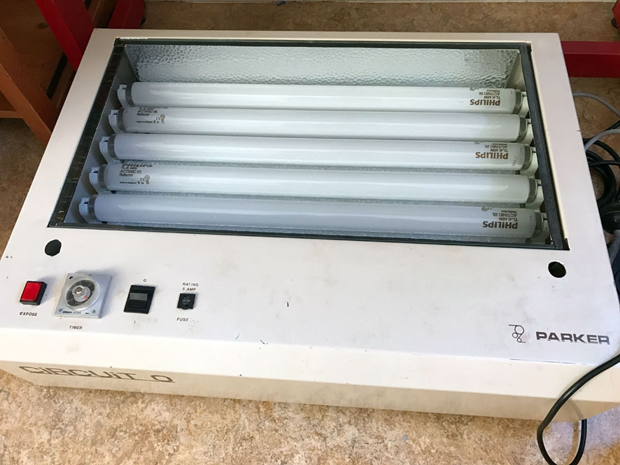

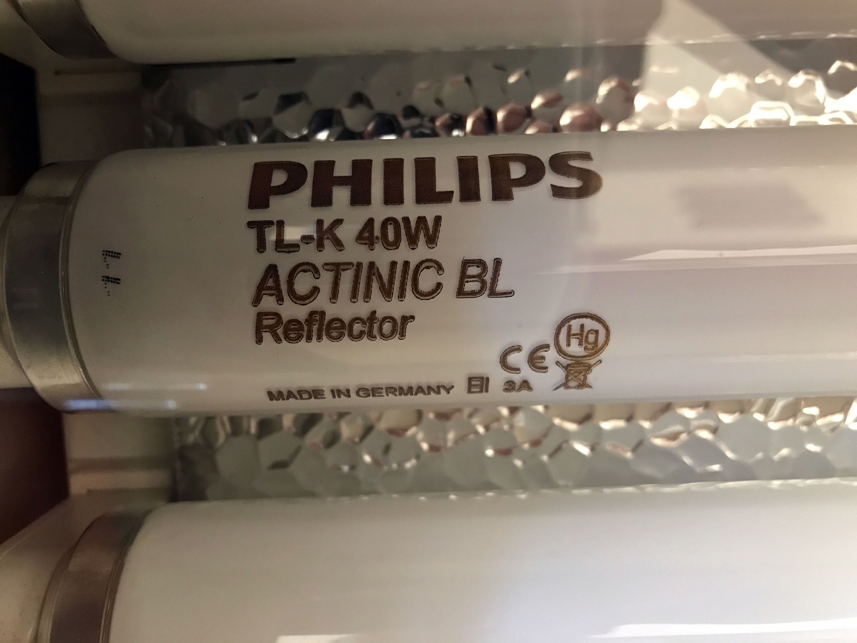

Yes I confirm. I've gotten in the past an used old print UV lichtbox. About A3 format. I use it for Cyanotype. Times 3 to 5 minutes.
Replaced later the tubes, because they only flicker and did not want to go to on.

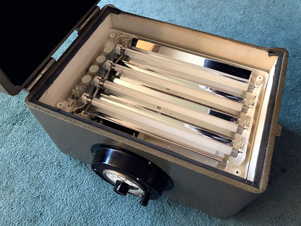

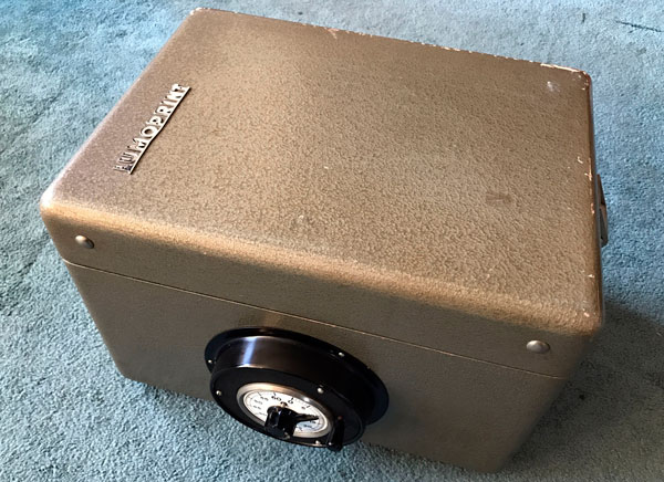

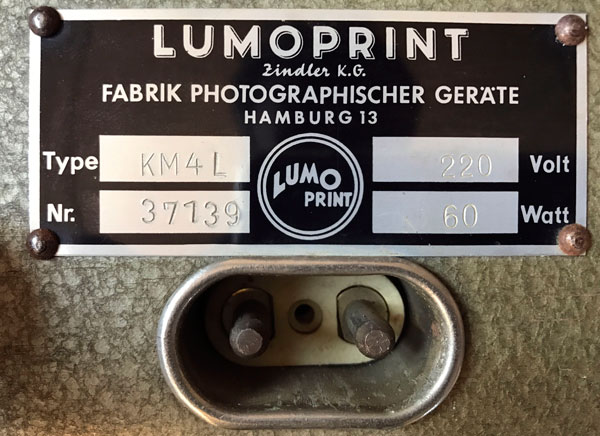

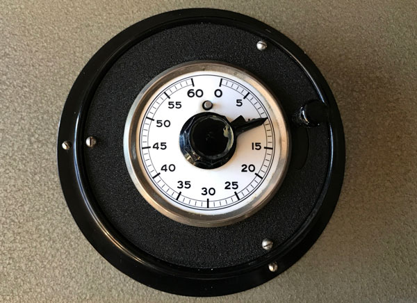

I also rebuild today an old Lumoprint box for A4. Original there where 4 small E14 15 Watt bulbs. I replaced inside with UV facial tanner found on the flea market.
The Lumoprint is great build. I think it's from the 50's but could be older.
