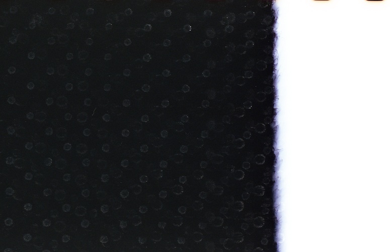

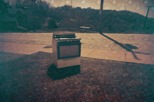

I'm curious about this pattern of spots that showed on this negative. I shot this roll redscale -- something I do quite often, and I've never seen this before. Can anyone identify what might have caused this? This is Fujifilm Superia 800 in the Vivitar Ultra Wide & Slim (a plastic lens, wide angle, point and shoot). To redscale, I unwind the roll into an empty 35mm cassette, cut, flip, tape, and wind it back into its own cartridge. This was all done in the dark. The film was developed at Target. The spots go to the unexposed edges of the negative (across the sprockets), and they seem to get less prominent with each frame, though they never completely disappear. The attached image is frame #2.
Thanks for looking.

Some kind of physical process error. Look how regular the pattern is- there is no way a camera can produce this.

Definitely from the processor, though I don't quite know how they managed that.

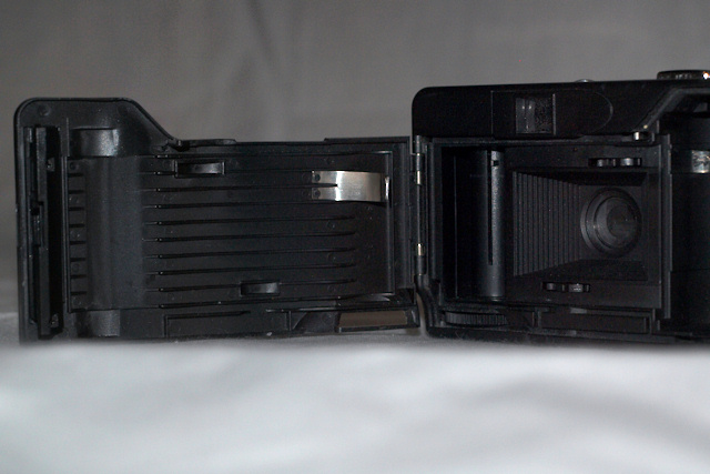

Is there a pattern on the film pressure plate in the camera?
Ooo... interesting thought. It does look like the pattern on my film pressure plate in my ME Supers...
Bvy mentioned using a P&S, not sure how the pressure plate would look.

I too thought it might be the pressure plate, because of the regular markings, but having see your posted photo I don't think this is the cause.

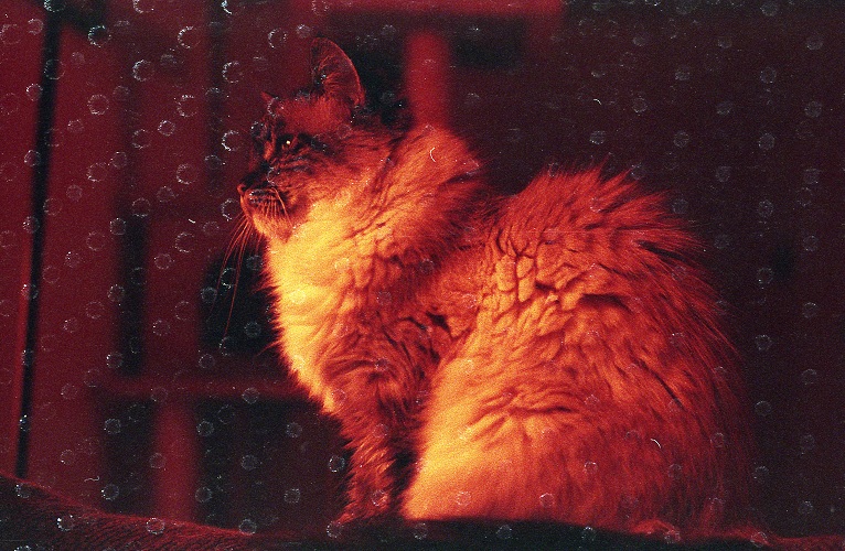

Alright, so I shot my first redscale film and am so happy with how much fun it was. But, turns out, I got the same pattern of spots you did... They are pretty prevalent with most of the images, only one or two within the roll have no spots. When I first developed at work (where I do minilab processing at Rite Aid) I immediately noticed the spots and figured it was the film pressure plate, since my Pentax ME Super has that pattern against the plate. But when I checked this thread and saw your camera did not have the same pattern on the plate, I became a bit a discouraged. I dug around on the internet with not much new info to share on this. One user on Flickr insisted on that the spots appear when the minilab processors process the film upside down (since the film is loaded upside down). But when I processed my roll, I flipped it over to the rightside up and I know when "trainees" process film, they sometimes process the roll upside down, but the results are fine. And in my particular case, to perhaps add even further confusion..., even the exposed leader portion from when I loaded my film to the camera, has the pattern of spots splattered across it. How could this be to a portion of film that was completely exposed to light like every other leader when we load film...??? Attached are a couple examples. One photo of what bvy shows, and one of my leader showing the spots. redscale sample 2.jpg redscale sample.jpg

Well, for starters, I'm happy to have introduced you to redscale. It's a great process when it works out, and I like the image of your cat. It's interesting that the same thing happened to you. This confuses me more. I've done redscale before using the same film in the same camera, processed at the same lab, and I didn't experience this. For example...
Unlike you, I did not flip the film right side up before having it processed. Like you, however, I did notice the pattern over the unexposed leader.
Also, they didn't cut the negative (into strips) but they did scan it to a CD for me. I doubt that had anything to do with it, but it's more information in any case.
What film did you use? Do you also notice that the spots gradually fade toward the end of the roll?

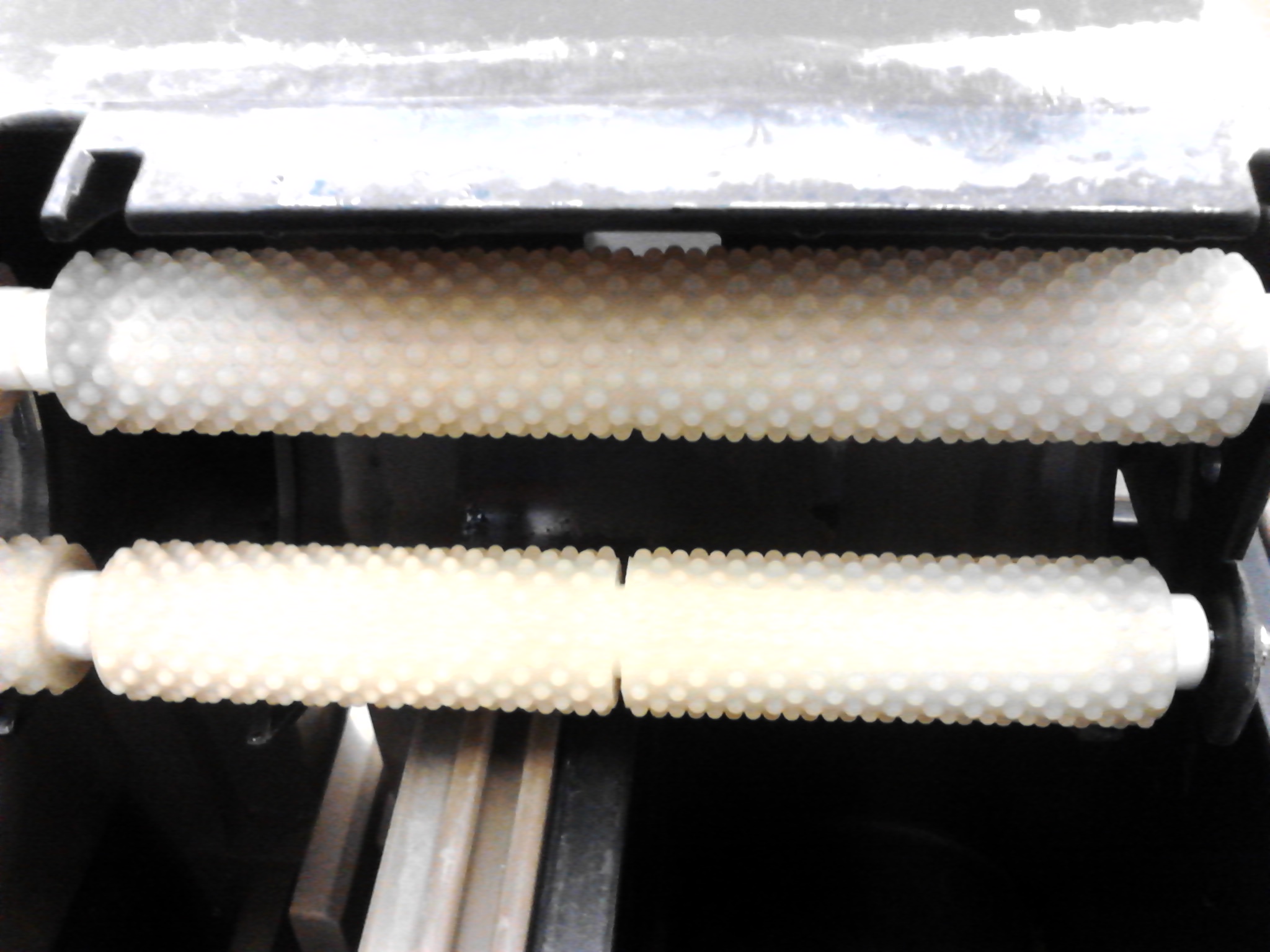

Finally found some useful info on flickr about our problem. Sounds like I actually did possibly load my film in upside down from normal, though I could've sworn I corrected it. But I could be wrong since I was a bit giddy at the time processing my first roll of redscale...
"I run a lab that has been doing Redscale processing for twenty years. The white spots are likely from a leader card/roller transport hybrid processor. It is not a fault of the lab or due to poor maintenance. You can keep this from happening by restoring the proper film emulsion direction after shooting and before turning in for development. Or better yet find a lab that understands your art and will treat your film as it should be. You cannot expect minimum wage employees at mass merchants to get this training. Before any film is loaded into a Noritsu or Fuji Film processor, it must be taped to a leader card. When we see the emulsion is facing the wrong (no not wrong ..just reversed) direction we put the film into a intermediate cartridge and process it with the emulsion facing the proper direction in the machine. The machines are designed with the rollers and squeegees facing a certain way to prevent any damage to the softened wet emulsion. The older Noritsu machines were advertised as "touchless" . Reversing the emulsion and letting the film run through the machine in the wrong direction exposes the emulsion to the parts of the machine designed to be in contact with the much tougher harder to scratch film base. The negative density and color tone remain the same regardless of direction of process."
After reading this, it totally makes sense with the Noritsu processor I work with. It uses rollers inside that matches the pattern we see on our negatives, that if the film was loaded improperly, the bumps on the rollers would possibly leave that pattern. That also explains the spots on the exposed leader. I almost feel relieved at this explanation. I will hopefully shoot another roll soon and process it at work, making sure I load the film facing the right way this time. When I finish, I'll report back! Until then, if you shoot another roll, I suggest respooling it again so it's back to normal, or informing the lab that the film is backwards and should be loaded upside down to correct for it....

I have a Fuji C42 leader card processor (FP363) and I have processed lots of redscale films and never had a priblem with the spots you mentioned no matter which way up the film was loaded into the processor.
However I did re-read the above from Flickr and then one thing struck me. The quote you mentioned
" The machines are designed with the rollers and squeegees facing a certain way to prevent any damage to the softened wet emulsion. The older Noritsu machines were advertised as "touchless" . Reversing the emulsion and letting the film run through the machine in the wrong direction exposes the emulsion to the parts of the machine designed to be in contact with the much tougher harder to scratch film base. "
I remember on an older Fuji C42 processor I had, that had squeegees (my current one doesn't) and yes they could cause patterns on the film if the film was inserted the wrong way around. BUT the patterns I remember look more like reticulation (crazy paving type pattern) rather than like the ones shown here.

I checked out the Noritsu V30 processor we have at work today. Here's a photo of the rollers that appear to have caused my issue. 0419121402.jpg
I'm convinced this must be the issue and I must have loaded the film upside down. I'll be shooting another redscale within the next couple days hopefully. I'll try processing it again at work, properly this time, and report back if that resolved the issue or not.

Hi cscurrier, having looked at your photo posted above I think you have solved it.
Just out of interest, where are these rollers located in the processor?
I wounder if the OP could re-wash his film and let it dry would that get rid of the pattern.

These rollers are part of the crossovers and sit right on top of the squeegee rollers that the film passes through between chemical tanks. The spotted rollers I took a picture of only belong to the fixer tank areas. All the others are smooth rollers. So I'm guessing the pattern gets imprinted on the emulsion during the fixing stages, since the emulsion is still wet.
Washing the film might be worth a try, but I'm guessing those rollers probably smudged the emulsion rather than leaving a faint mark.

So I quickly shot another roll of redscale and developed at work. I double then triple checked that I loaded the film properly into our processor. It came out spot free. I think that solves our mystery!
