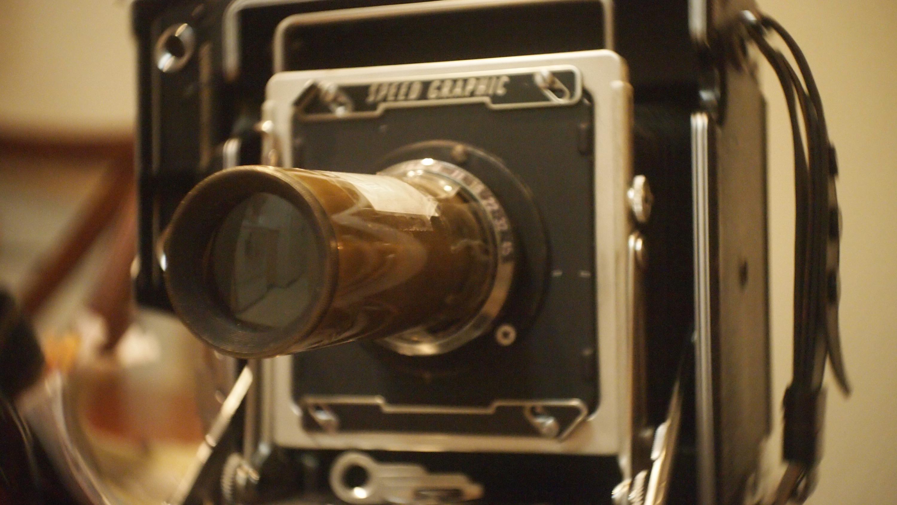

Hi all:
I am just wondering if anyone has or use Pathe Freres Paris Len on Large Format, information, or having pictures taking with this len, since the information I found on the net is limited. From what I gathered, it is made by a French company in early 1900s. I have a Pathe Freres 125mm at about f/5 that I put on Speed Graphic and 200mm at about f/4. The 125mm is a Cinema len (with Cinema line being scripted on the len) and the 200mm seemed to be a projector len, although I can be wrong. Both do not have Waterhouse stop although the 125mm has a built-in stop inside the len's barrel which can be modify to further stop down. Correct me if I am wrong but both len are Petzval-type construct after I disassembled the len elements. The 125mm seemed to cover fine by 4x5 and the 200mm's image circle is bigger than 240mm Schneider which seemed to cover 8x10 although I did not try it on 8x10 camera yet.
I attached a pic of the 125mm being adapted on my speed graphic taken with EPL-1 using 25mm Wollensak len :smile:
