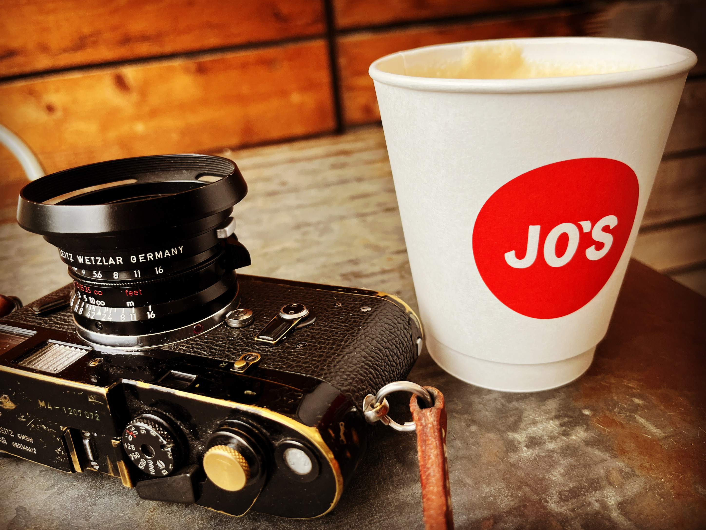

Just to underline the point that i'm not picking on Eddy Van Wessel, while clutching a perfect-as-the-day-it-left-Wetzlar M4: to paraphrase Nancy Sinatra "this camera was made for using" ...my M4 1C4A8FB1-0402-4BEF-9678-80E35DBEE609.JPG
