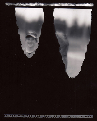

Just a quick and dirty scan of a contact print -- dust and all!
Calder (and carved bear)
Print from a Type 55 negative

The 'tongues' (2 in this case) are typical of developer layer spread problems. If the original poster saw a straight edge, it's less likely to be a spread problem.
