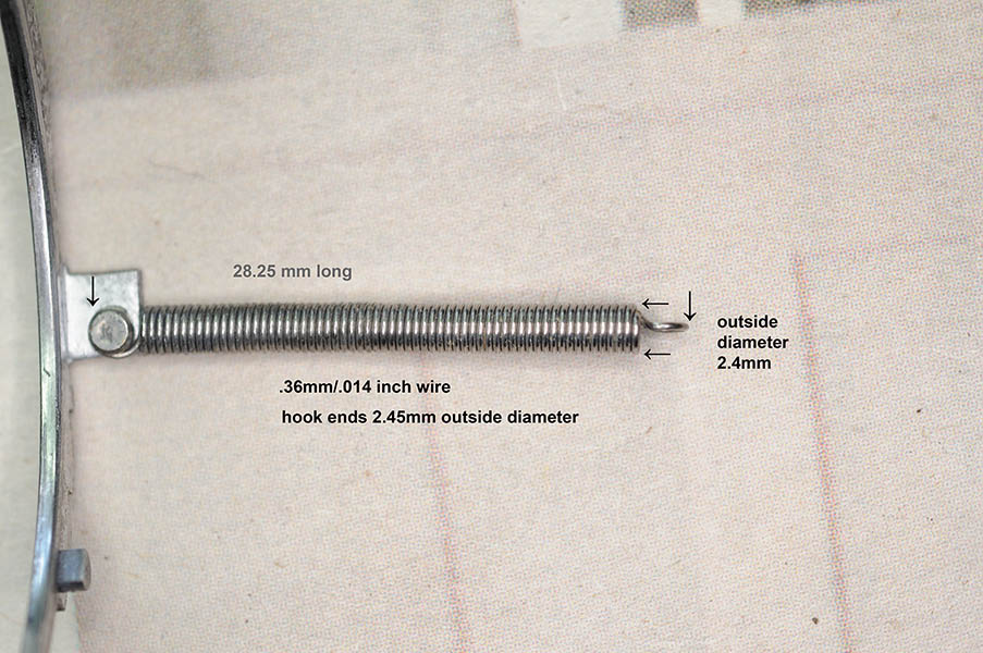

After a CLA on Synchro Compur #2 it works correctly. Eye against a sweep second hand shows 1 second to be approximately .9 second and 1/2 second close to .5 with all other speeds increasing over the previous proportionally.
The bad spring shutter needs 900 grams of pull to cock it.
The good spring shutter takes 1400 grams of pull to start the cocking lever moving and then drops to a steady 1200 grams of pull to full cock position.
The good spring and its measurements:
attachment.php
I think a Copal #1 will be a direct replacement for the Synchro Compur.
