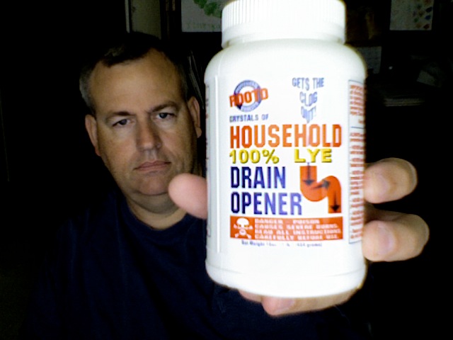

Well it's been 4 days since i made my homemade version of Parodinal. From the Digital Truth website.
I made a 500ml version, and it is starting to turn brown. Apparently that is a good sign as the Sodium Hydroxide is turning the Acetaminophen into p-Aminophenol Hydrochloride My liquid is not clear. It is more milky.
I used filtered water from the refrigerator. I was going to get distilled water but ran out of motivation to run to the store. My second thought was to use a Brita water Filter...
I got the Store Brand Acetaminophen, and the Sodium Hydroxide (Lye) in 100% pure powdered crystals from Ace Hardware in the drain section. It does not have the metal flakes in it. It is a pure crystal powder.. It's labeled "Household 100% Lye Drain Opener".
I was going to order the Sodium Sulfite from Photographer's Formulary, but I was trying to make the solution from all just regular stuff, as I have a friend in China who wants to make his own and he can't order anything into his country, so I used instead Sodium Metabisulfite. I purchased it at my neighborhood beer and wine store. It was $4 a pound. I hope it works, so I can at least try this. Sure, I could actually order all the things I need from the proper places, but again, I am experimenting to see if what a hastily threw together works, so He can experience Rodinal. I do believe He tried to bring Rodinal back into China from the West, and it was confiscated. I would be Pissed if they took my Rodinal (Adonal). They would have to pry it from my cold dead hands ! So I'm just trying to have a little fun and help a buddy out.
