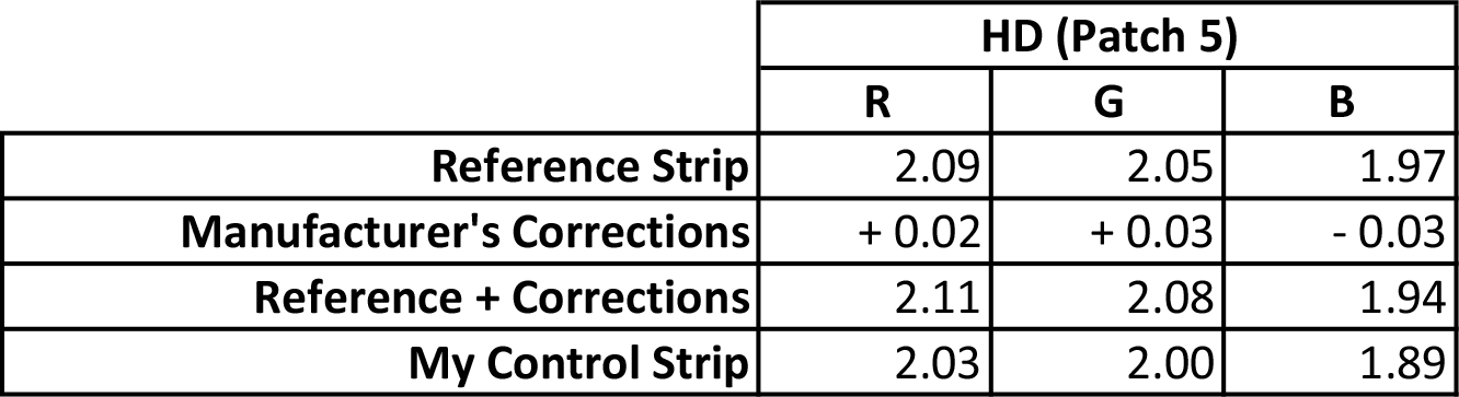

On the specific question about how the color spread calculations are performed, let's say I've collected the following data for the HD patch:
Here's the approach I'd tentatively take:
  • Calculate the color spread in the corrected reference strip: (2.11) - (1.94) = 0.17
  • Calculate the color spread in my control strip: (2.03) - (1.89) = 0.14
  • Calculate the difference in color spread between my control strip and the corrected reference strip: (0.14) - (0.17) = -0.03
  • Conclude that, since -0.03 is inside Fuji's published control limits of +/- 0.13 for the HD patch, my process is in control.
  • Repeat the above process for the LD patch (where the control limits are +/- 0.08).
Does that look about right to you? Many thanks.

Hi Scott, Yes they look fine but there's no reason to actually note these unless you're not plotting your readings.
Like I said, once plotted on a form, you have all the information right there in front of you.
When you start to run E-6 control strips, it's vital to factor-in the correction values from the reference strip readings as your aims.
As a visual check, you can examine your processed strip next to the reference strip on a ( good quality ) daylight balanced lightbox.
