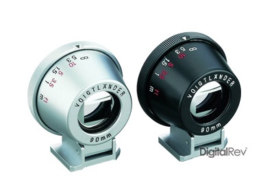

Hello everyone, I am having some issues with my 90mm Elmar using it on a IIIf with a voightlander Viewfinder. I am finding that even when I am using the correct distance on the scale and using the outer lines at infinity my framing is not correct. I am having maybe 20% of the frame incorrectly framed on the top (20% too much sky). Is this the correct viewfinder to use with a IIIf?
All help appreciated.

This is the correct viewfinder to use. And you move the scale to infinity when photographing a DISTANT view, right? And there is still too much sky?

So that's not good because setting a shorter distance on the viewfinder scale would result in even more sky. (If I've got my geometry right.)
Is the finder sitting right in the camera's accessory shoe?
If yes, then I think the finder's parallax compensation is out of calibration. I don't know if this can be adjusted.

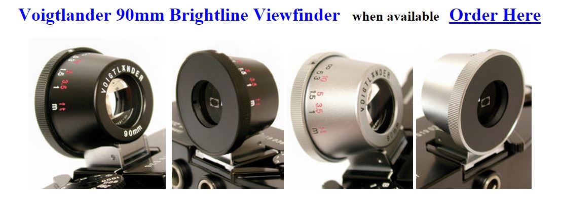

Ok, I have been using the exact same viewfinder (black) with my Elmar 90/f4 on a II with no trouble. In fact it was the first Voigtlander Viewfinder I bought to work with my 90mm APO-Lanthar and it seems pretty well matched up with that lens as well. Parallax correction works pretty well. I'll hook the setup up to my M9 tomorrow and do some testing to see if I notice anything really off but I would suspect that somehow your parallax correction has gotten out of whack.
