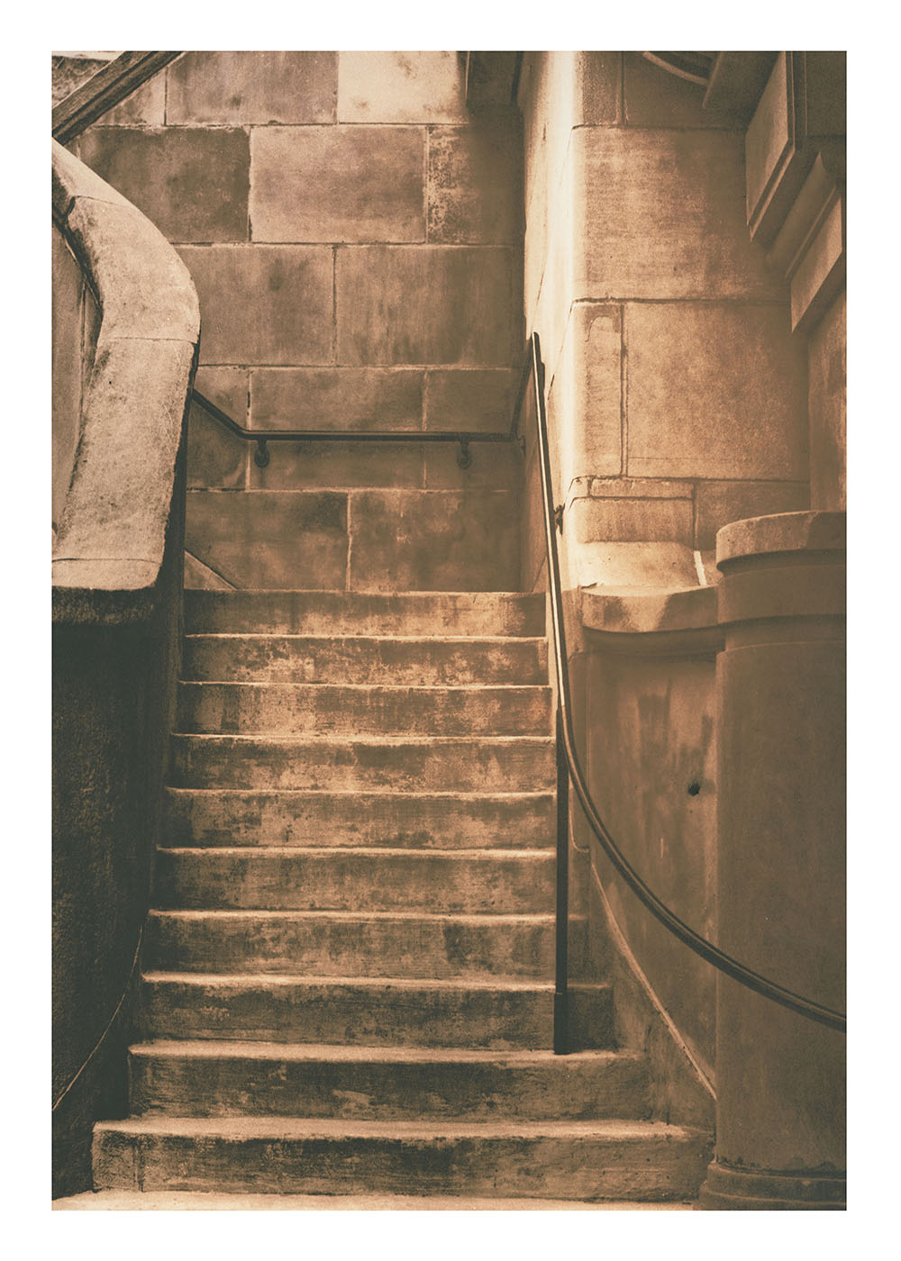

Browning - I'm talking new papers. I get what I consider pretty pleasing yellow/oranges - see the attached.
Thank you. That has a very pleasing color to it. I'll add it to my shopping list.
