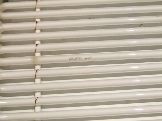

My enlarger has an Aristo T-12 head (cold light) and now i understand why the Ilford filters were not giving me the results expected.

The datasheet mentions that the Aristo bulb W-42 (which you likely have in your T-12 head) can have improved spread of contrast grades with additional yellow filtration. I used a W-42 lamp for 8x10 printing a few years with additional yellow and the Ilford filters with success. You can upgrade your Aristo lamp also. The new owner of my Aristo head replaced the W45 with a new lamp made by Aristo.

Thank you for this information as well; you seem to have been down this trail before.
It is nice to know that Aristo is still around.
