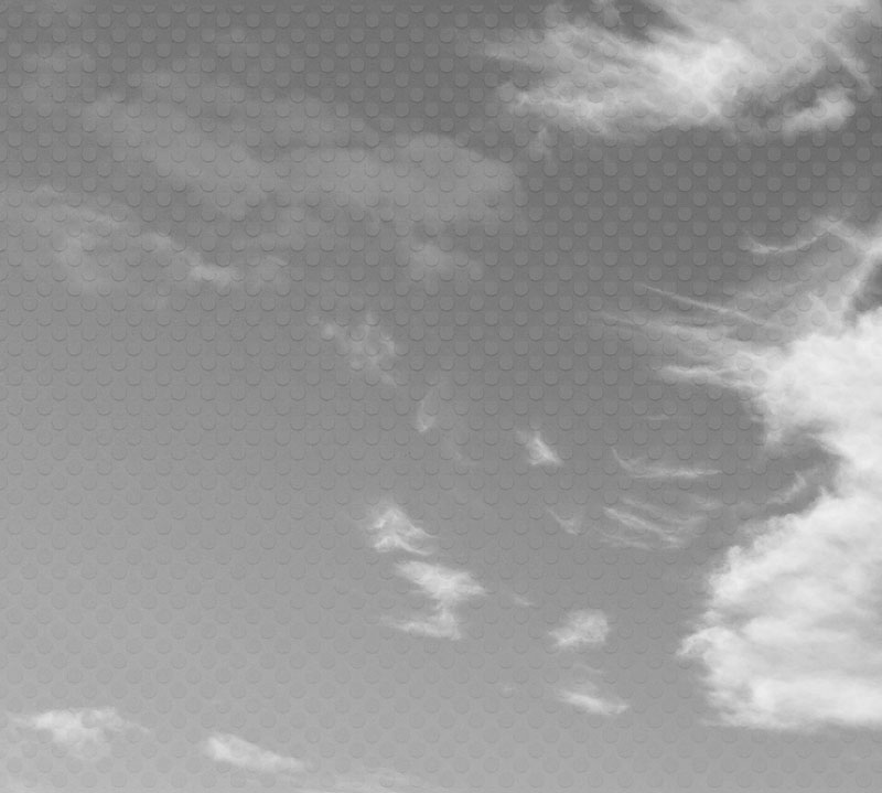

I don't remember what it was called, the ugly surface with tiny embossed evenly-spaced round dots. Who used that, and why?

Pebble finish?
On color paper that's "silk" finish. Possibly it's also used for a similar finish on B&W RC paper.
Without having a print with that texture I made a simple illustration. The embossed dots are of course much smaller in real life:

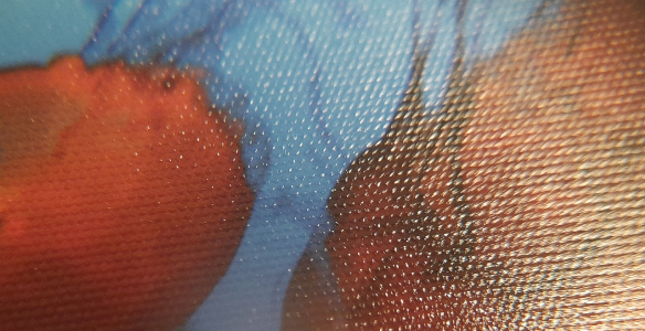

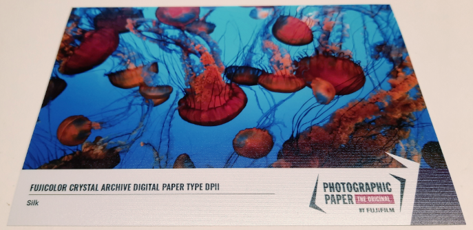

That's probably it. They should have called it "table tennis racket" instead of "silk".
Yeah, it's a bit of a misnomer if you ask me.
I still have some Fomatone 532(?) that has a very similar texture. I haven't used it much. So yeah, there's a B&W equivalent. I think Agfa used to have something like this and I think it also existed in Kodak Endura/color.
Nicholas Lindan
Advertiser
Advertiser
Sep 2, 2006
4,252
Cleveland, Ohio
I think this was called a 'canvas' texture in the past - I imagine as a reference to an oil painting on canvas.
Kodak offered the X surface, called Tapestry, Y - Silk, R - Tweed, D & K - Fine Grained. Tapestry was the most aggressive texture.
koraks
Nov 29, 2018
23,677
Europe
It's possible, although I know that Fujifilm also had a different texture they called 'canvas', which did in fact resemble a rather artificial canvas weave (so it certainly wasn't this 'silk' finish). It was introduced only a few years ago, but I think it has already been axed as well. Since this is a color product and quite recent, it's likely different from what you mean. I don't know if what I know as 'silk' was marketed as 'canvas' earlier; it's possible I guess, although it doesn't look particularly 'canvasy' to me.
Out of the Kodak line, I'm really only familiar with the 'silk'.
I think nearly all of these are textures (on RC papers) are imprinted on the roll after the paper is coated and dried. So calendered/embossed. At least that's how Fuji does it and how Kodak AFAIK did it, as well. They're not actually different paper bases; they're quite literally 'finishes'.
