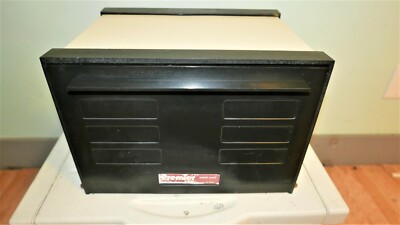

There are/were paper safes available that were set up to eject a single sheet when you open a door. I have a couple of them (in storage), and have used them in the past. They are a bit finicky to use and to load with paper, and you have to be careful to ensure that the pads that make contact with the paper are maintained.

Like Matt mentioned, the automatic ones intended to dispense 1 sheet at a time are tricky.

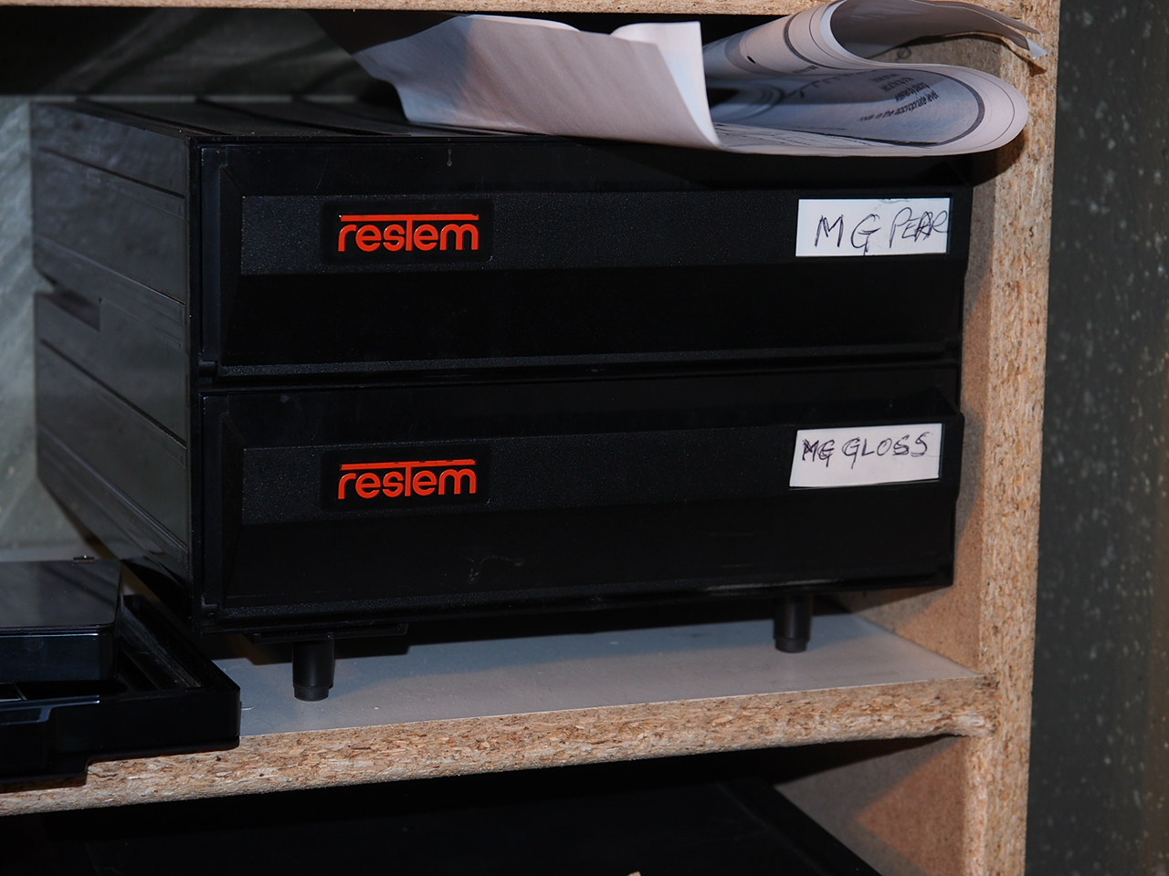

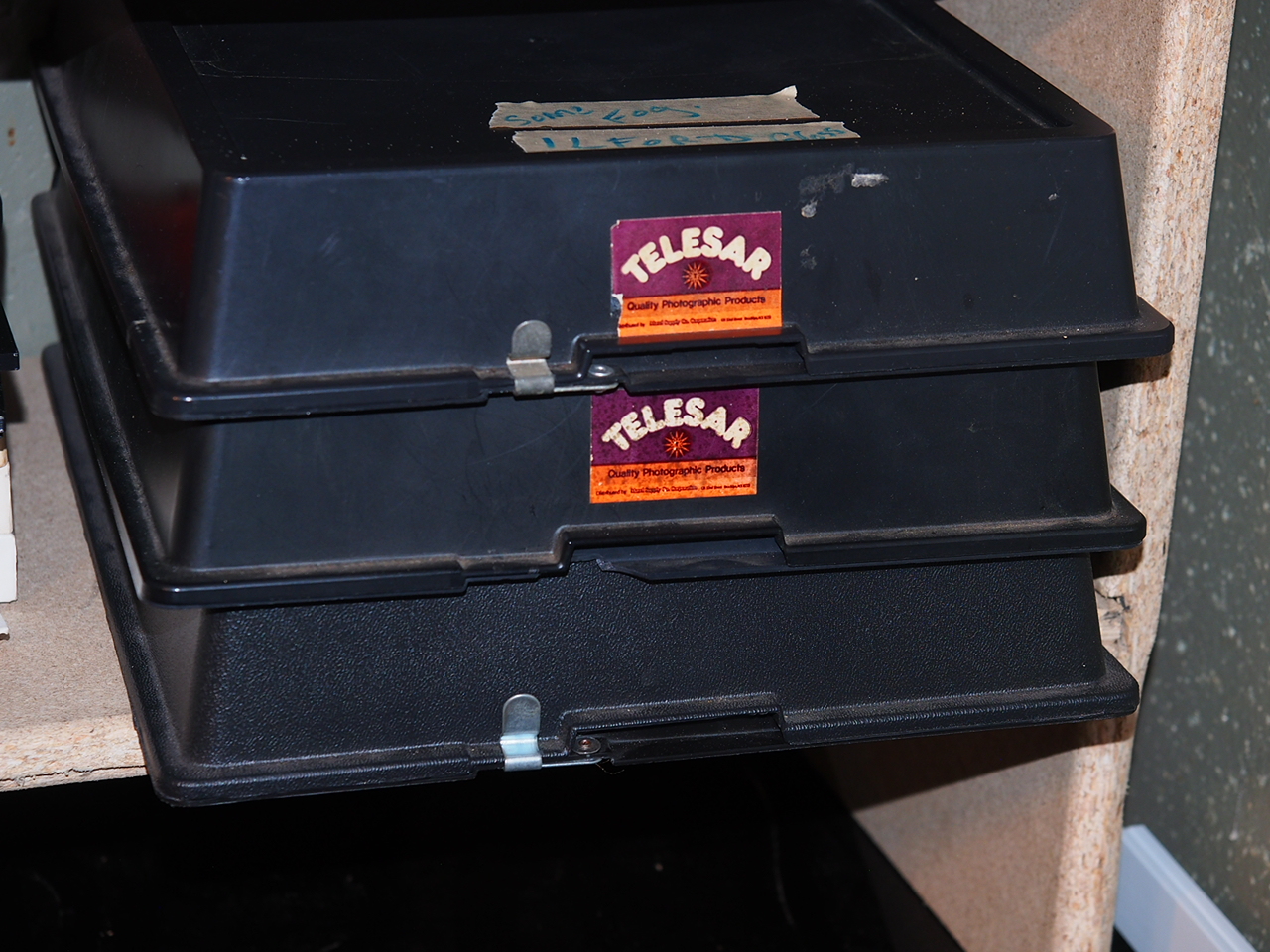

Perfect description. With this new closure sounds like it is perfect. I use this type of paper safe for color paper, they are perfectly light tight.
The Telesar is just a light tight box and is better if you store test strips.
The Restem feeds one sheet at a time and 'was ' better when I did mass production for my daughters school year book.( many many years ago!)
Best to separate the paper as with a deck of cards! before loading to prevent some sheets sticking and don't load too many.
Pulling out one sheet from a package is doomed to have finger fixer stains at some point..
