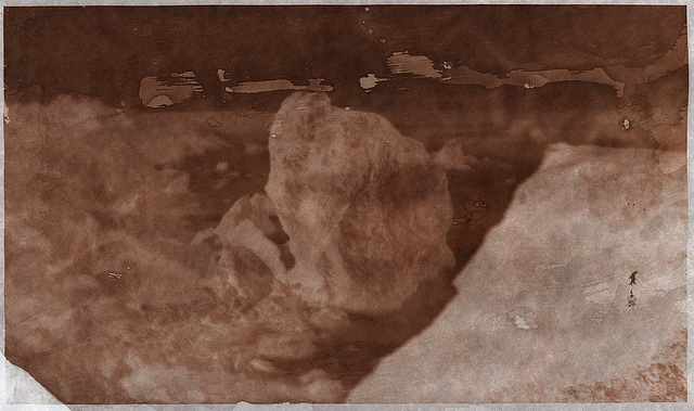

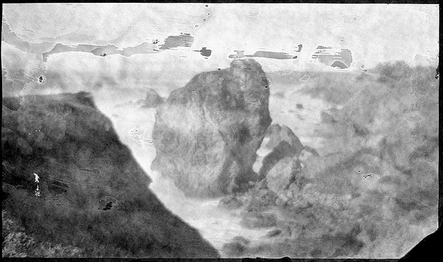

Don't laugh.. this was my first try ever and there were some problems. Not the least of which was that my camera was not in focus. But the paper was not completely blank or completely black.. there is a recognizable picture. First try at a calotype, and an inverted scan of it.
First calotype par Ned, on ipernity
Rock Point calotype. par Ned, on ipernity
No it's not a Rorschach test... I was at the coast and there was big surf crashing in :smile:. If you see butterflies or something you'll have to talk to someone qualified to learn what that means....
