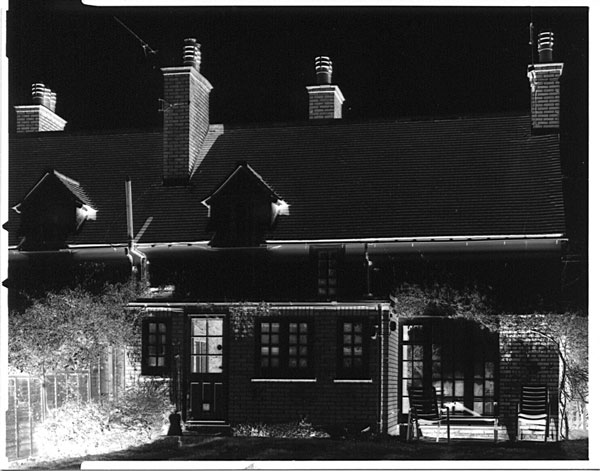

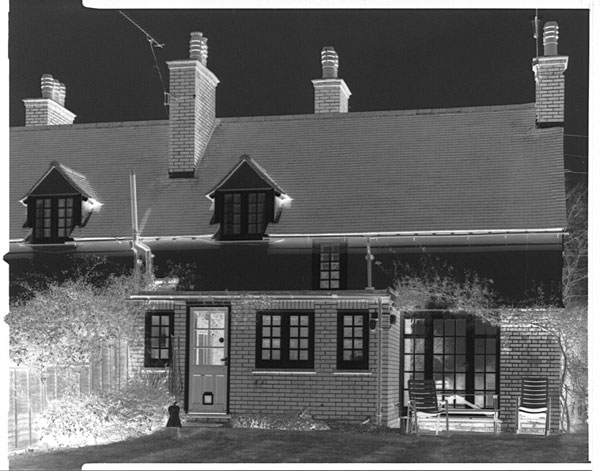

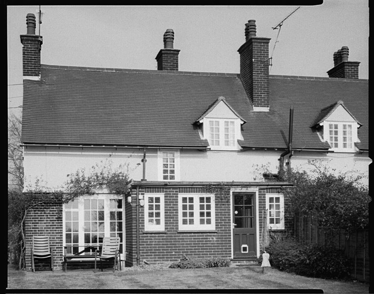

Photographic paper is very sensitive to blue light. The yellow filter works wonders, but of course, it does need a stop more light. I usually use Ilford MGIV-RC at ISO 2, and in addition, dilute the paper developer 1+8 instead of the usual 1+2. Attached are my results:
