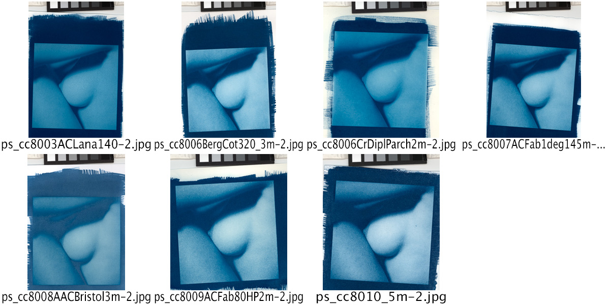

I was taking a look today at some of the cyanotypes I made last year. I had different variations of one image scanned in and to my surprise I had labeled the paper type when I scanned them so I'll post it here.
The paper type is in the name, as is if the paper was acidified (ac) before coating. All papers are Hot Press if watercolor papers. Across you see Lanaquarelle, Berrger Cot320, Cranes Diploma Parchment, Fabriano 1º, Canson Bristol (solarised), Fabriano 80/20 (I think) and an unknown paper.
I have prints on other papers as well, but I don't have them scanned in. Somerset, Kozo, Stonehenge, Lana Pur Fil, Artistico, off the top of my head.
Hope that helps someone.
All of those prints look "pretty good" or better.
Are you using the traditional cyanotype or the modern version? How are you "developing" you cyanotypes... plain water, or with an acid in the first wash?
My understanding is that the traditional cyanotype is not particularly sensitive to the presence of buffer in the paper but that the modern version is quite sensitive. Thus if you are not using one of the unbuffered papers designed specifically for alt processes and you are using the modern version of the cyanotype sensitizer then acidification of the paper is important.
Using only the traditional cyanotype sensitizer, and developing my prints with 25% (v/v) vinegar, I have not found a need to pre-treat any paper with acid.
That said, I have never done the experiment directly comparing a paper with and without acid pre-treatment. However, this afternoon, when I was in the hardware store I bought some sulfamic acid and have put the experiment on my to do list.
Now all I need is time!!!!
