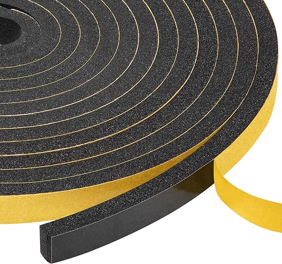

Many years ago I managed to fix this problem on an old Ilford 4250 RC dryer ( I think it was this model ).
The foam rubber on the exit rollers had perished and the machine would have been thrown out, so thought I'd have a go since we had nothing to lose.
I bought a roll of foam door strip ( easily available - see photo ) and stuck it down in a spiral fashion along both rollers - and it worked perfectly !
It was tricky to do as I couldn't take the rollers out for some reason, but it solved the problem.
Note this was on the exit rollers, so I would imagine it might not work with wet paper on the 'wet intake' rollers.
John S 😎
Great minds think alike?
A number of years ago I acquired an Ilford RC paper dryer in a darkroom lot with the foam exit rollers disintegrated. I did the same thing, spiraled window sealing foam on the rollers. Years later it’s still holding up.
