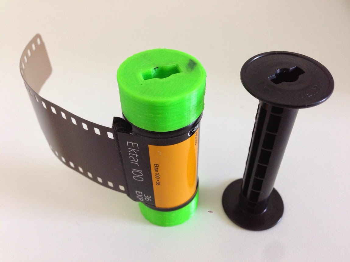

Any one using a RZ67 for panorama pictures? I bought a kit that transfer 35mm film canister to act as 220 film
I have also bought a 220 magazine, and it should give me 18 pictures.

I often shoot color, if i use 120 i will need to send it away and it takes around 2-3 weeks to get it back. With 35mm i can go to a local store and they will develop it in 2 hours.
I also like the effect where you see the perforation.

Use mamyia rb 70mmback-with vaccum-option -rzu-g-adapter needed and cut 70mm into 2 pieces. bhvideo has the alden 70mm bulk-film loader. with the 120-35mm-adapter one can at least use unperforated film. have a slitter to cut it out from 70mm perforated since unperforated is hard to get let alone 35mm unperforated.
xkaes at aol.com delivers the slitters, most of the time with multiple weeks or months production time.
maybe you could post a link to the sales-site. on original one -the pinholecam-makers-its not available.
europanorama
Aug 10, 2004
381
Basel-CH
Large Format Pan
The 3DPrinter of this spool has now a metallic version. i would get that one since i observed the plastic one producing residues. AND: DONT ever use in kiev60 and other cams of the same types. its will kill the axis of the spring-mechanisme pushing cartridge into position. and: film will never be flat.
I was told mamyia 7-panoramic kit is the way to go. the is also one for pentax 67, dont know if it matches.
