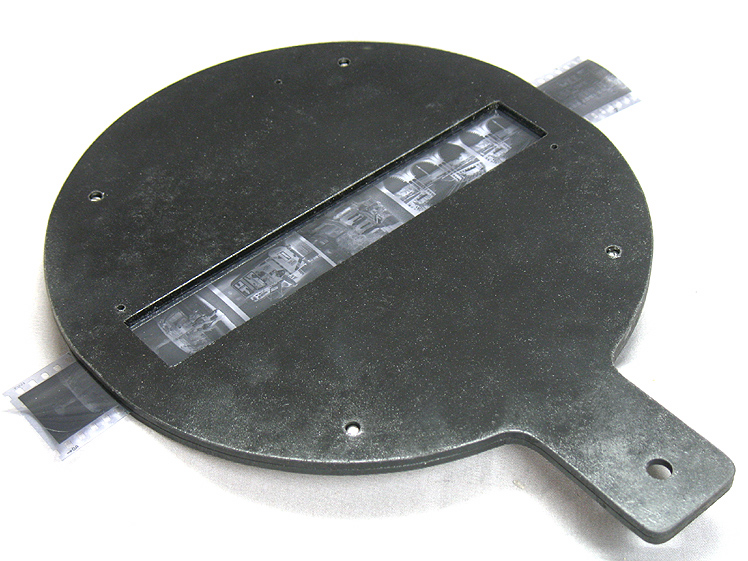

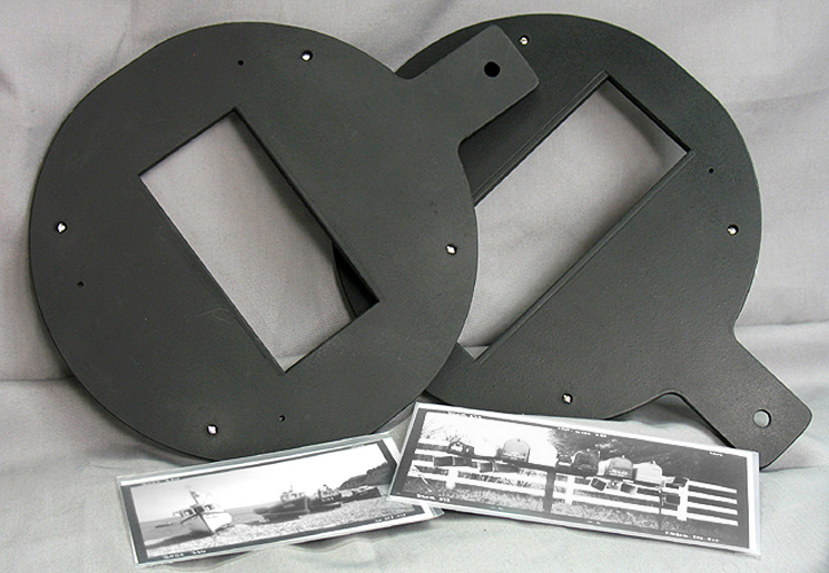

Looking for negative carriers?
Check the classified section for some of the options available for Beseler and Omega 4x5 enlargers.
Especially if you're trying to print Lomo Spinner 360° negatives...

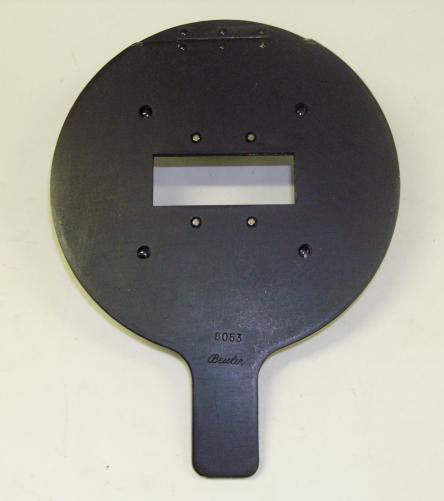

How about a negative carrier for Xpan negative for Beseler 23C?
I brought extra 135 and 6x6 Omega carriers to a local machine shop and they widened both for me at a cost of an hour's labour. About $100 in total.
Send SK Grimes a regular 35mm 23C carrier and they will machine it out to 24x65. Cost in 2006/2007 was $65.
I have made a couple with a coping saw and files (two 35mm negs and three 35mm negs -- Omega neg carriers). pretty easy.
