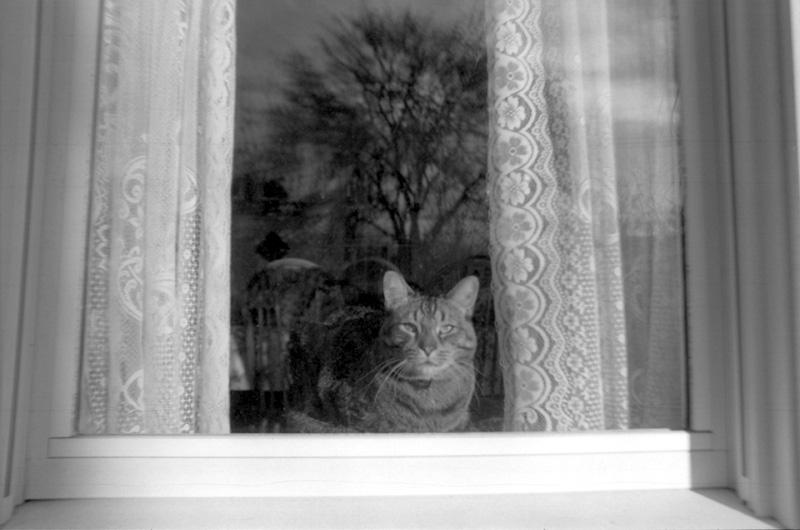

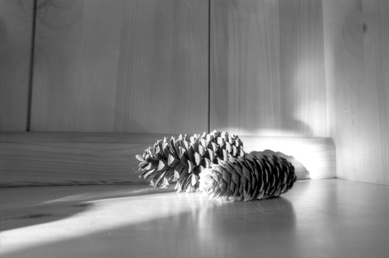

Well, I loaded up a cassette with some of the Pan-X and shot various objects with my Nikon N90s (sorry, most with 'program' :tongue:) using a Sigma 28mm f1.8. The negatives are still drying, but I am pretty impressed if not amazed. This film must have been sitting in the bulk loader a min. of 25 years, but realistically more. Once it is dry, I will post an image or two and see if I'm still as enthusiastic. I did increase the development time by 20%.. just a seat of the pants, last minute decision.
Pan-X was a very nice film and I shot many, many rolls of it. I was very sorry when Kodak decided to end its production. I mainly developed it in either the Beutler formulla or Rodinal.
Well, no prize winners :wink:, but I was just trying to see what it would look like. I probably should have skipped the +20% on development at least, but I am surprised at the image quality for 25-30 year-old Pan-X. It sat in an Alden bulk loader in the basement all this time. Our basement is very dry (for a basement) and the temp never gets above 70F.

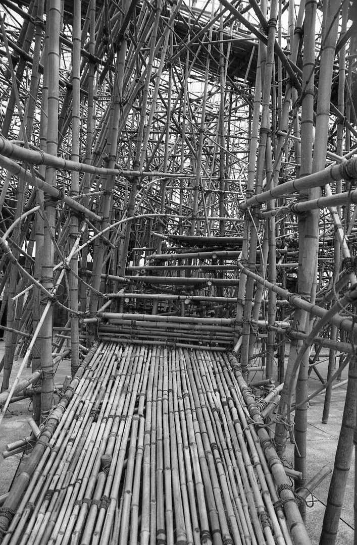

Panatomic-X is no more, but if you like that sort of thing, we still have an old school slow B&W film in Ilford's PanF+. Used under the correct circumstances, it's pretty good; but if it's really fine grain you're after without the inherently high contrast of PanF+, there's TMX from Kodak and Acros from Fuji. Either will work better (if I dare use that term around here) under a wider range of lighting conditions. The attached photo was made on PanF+
