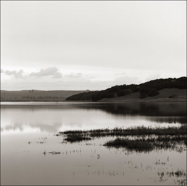

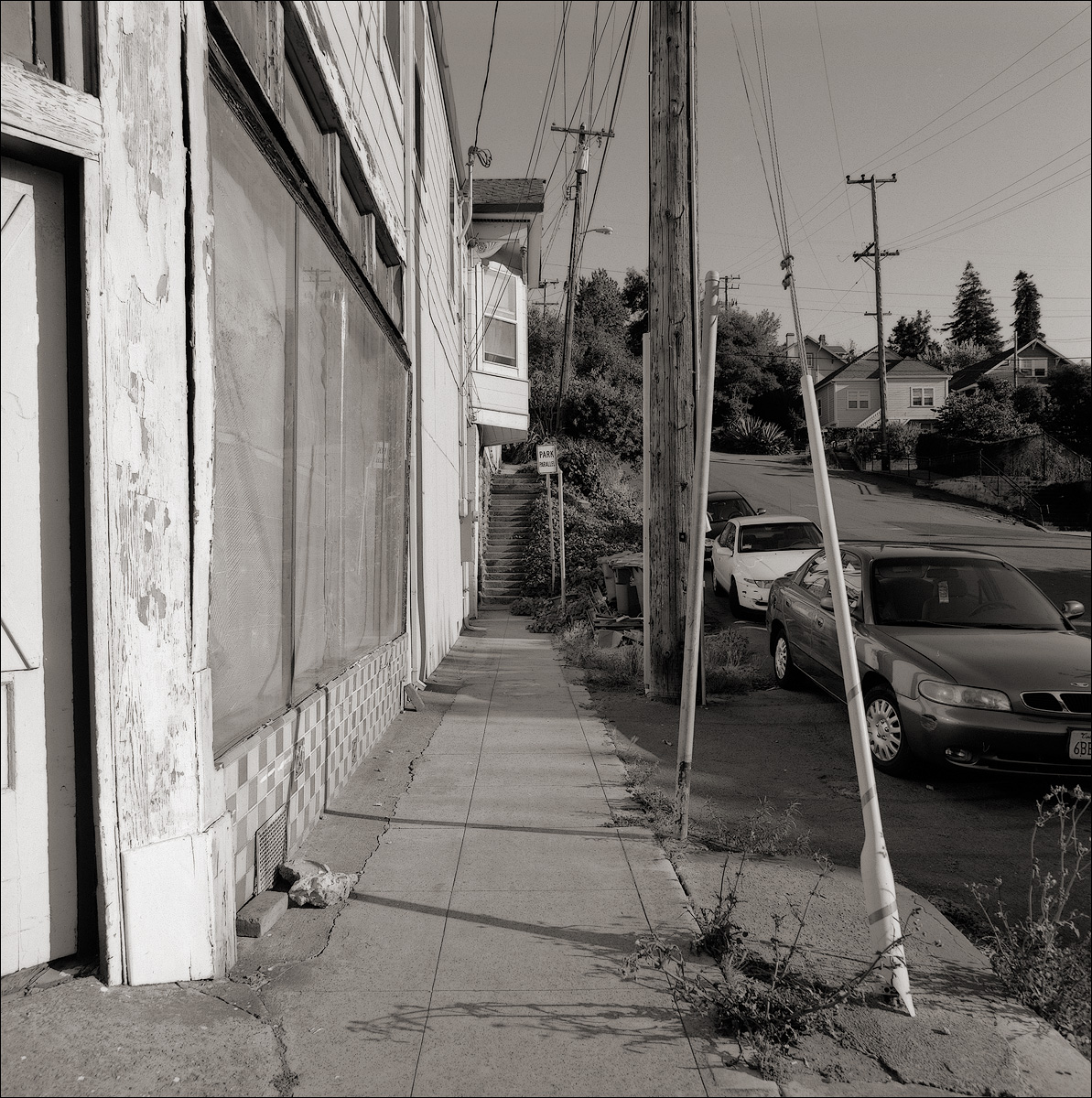

I find it a wonderful film and with numerous developers. Even in constrasty situations, as people often warn against for Pan F, if you exposure for the shadows you'll do fine. (Under most contrasty situations I follow a regime of rating the film about half and pull back development time about 20% or so to work for me). If you're not careful you will get bullet-proof hardcore contrasty negs which are tough to scan and tough to print, at least with a nice smooth tonality. Here's a few examples below, the first and the third taken in full blown contrasty sunlight:
Rolleiflex 2.8C Xenotar, Ilford Pan F developed in Perceptol 1-1:
Hasselblad 500CM, 150/4 Sonnar, Ilford Pan F developed in DD-X 1-9:
Hasselblad 500CM, 40/4 Distagon, Ilford Pan F developed in Rodinal 1-50:

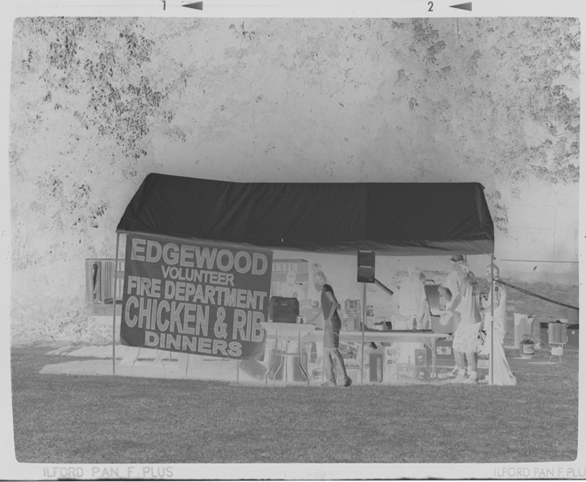

My roll was shot with an old folder and developed in D76
There was a cooker behind the tent that had smoke above the tent top. F16 1/50 bright sun and there is still a ton of detail under the tent. That really surprised me. I could not see anything with my eyes that day. It was really bright out.
I remember seeing this as a positive and it did hold the scenes lighting just about perfect. I wonder if the leaf shutter on your old folder was a tad slow? The reason I say this is because it sure looks like it had generous exposure. Using "Sunny 16" your exposure EI would be ISO 50 rating and this looks more like something in the rating of ISO 25 or even less. Still, with that camera it's near perfect. I also think you hit the development/agitation time pretty much on the money. I don't remember the scan being bitingly sharp, but certainly sharp enough for an old folder since they sometimes can be iffy that way.
