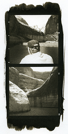

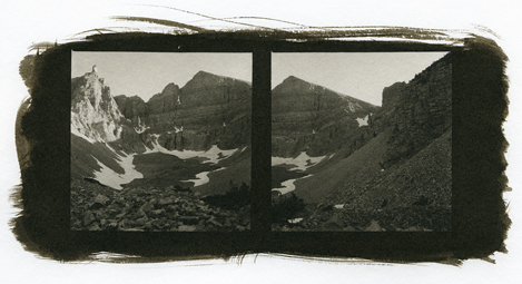

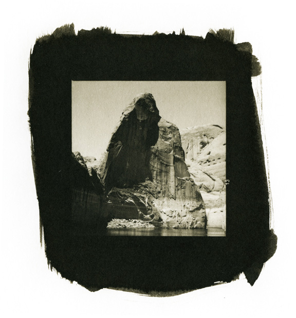

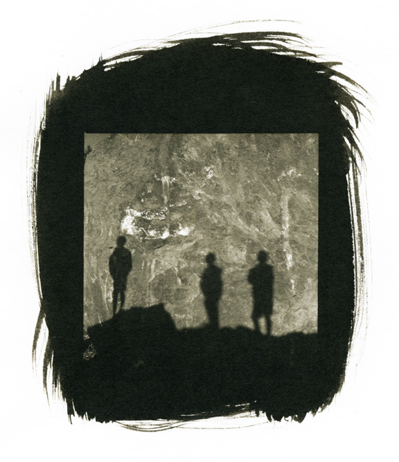

PS...I made some small palladium prints, using NA2. A little NA2 goes a long way!
First two -- Lake Powel. Next -- Shadow Brothers, Luffenholtz Beach. Far right -- Wheeler Peak, Great Basin NP, Nevada (All w/ Rolleiflex TLR)
