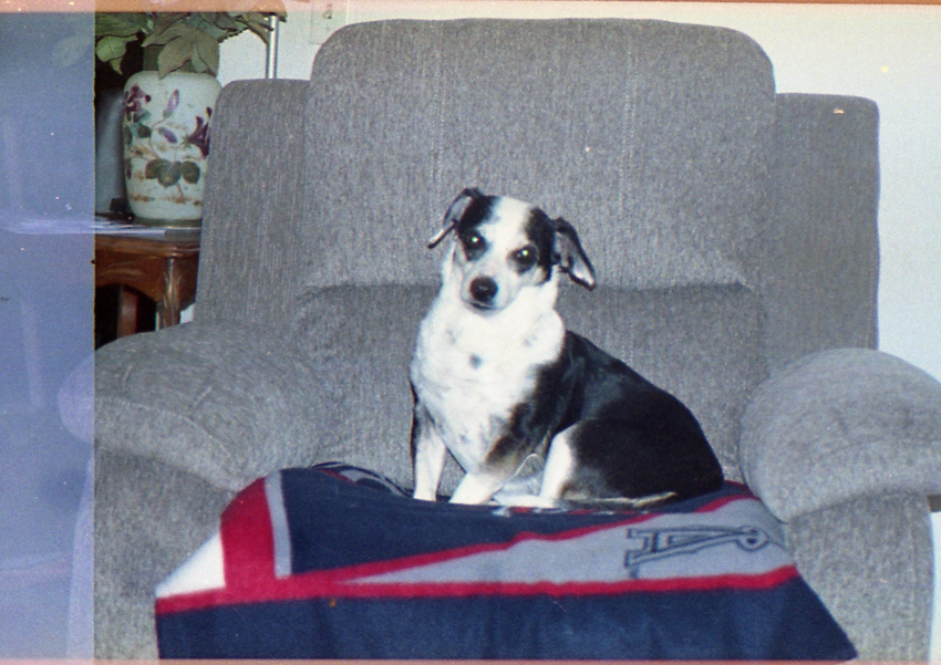

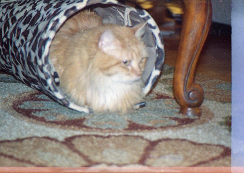

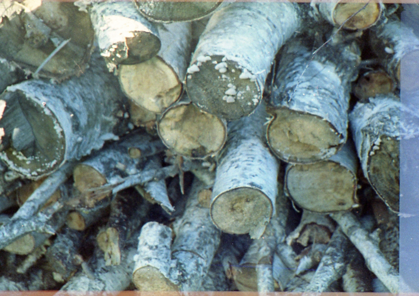

These are from the first roll through a Pentax Auto 110. They all have a pale band running vertically of varying widths. The film expired in 2004 and has been in very questionable storage.
I am guessing that the pale band is caused by a faulty shutter. What do you think caused it?

The pics you are showing us are scans from the negative or from prints?
Did you develop yourself or did a lab do the job for you?
I remember back in the 80s/90s, I used to get prints with strips like that which I attributed to bad processing of the print.
Can you show us a picture of the negative strip?

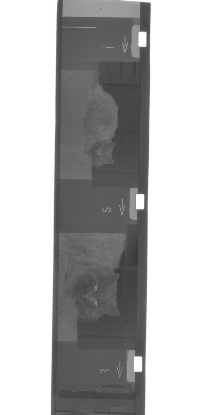

Here are pictures of the actual negatives. Now that I inspect them more closely, it appears that the pale bands may actually be light leaks originating from the holes in the film. I've seen this on all 3 rolls I've shot of this expired 2004 Kodacolor II cartridges - each roll shot in a different Pentax Auto 110 (don't ask me why I have 3 of them - it just happened - really)

The bands are pre-printed on 126 film. I assume it is the same with 110. Notice that the area between images is dark, not light as you would see on a 35mm or 120 negative. It appears that the camera is not properly positioning the film. I don't know why Kodak did that. I have seen similar issues when dealing with old family photographs shot on 126 where the blue lines went right down the middle of images.

Big question now: was the film mispositioned in the cameras or when doing the prints?
