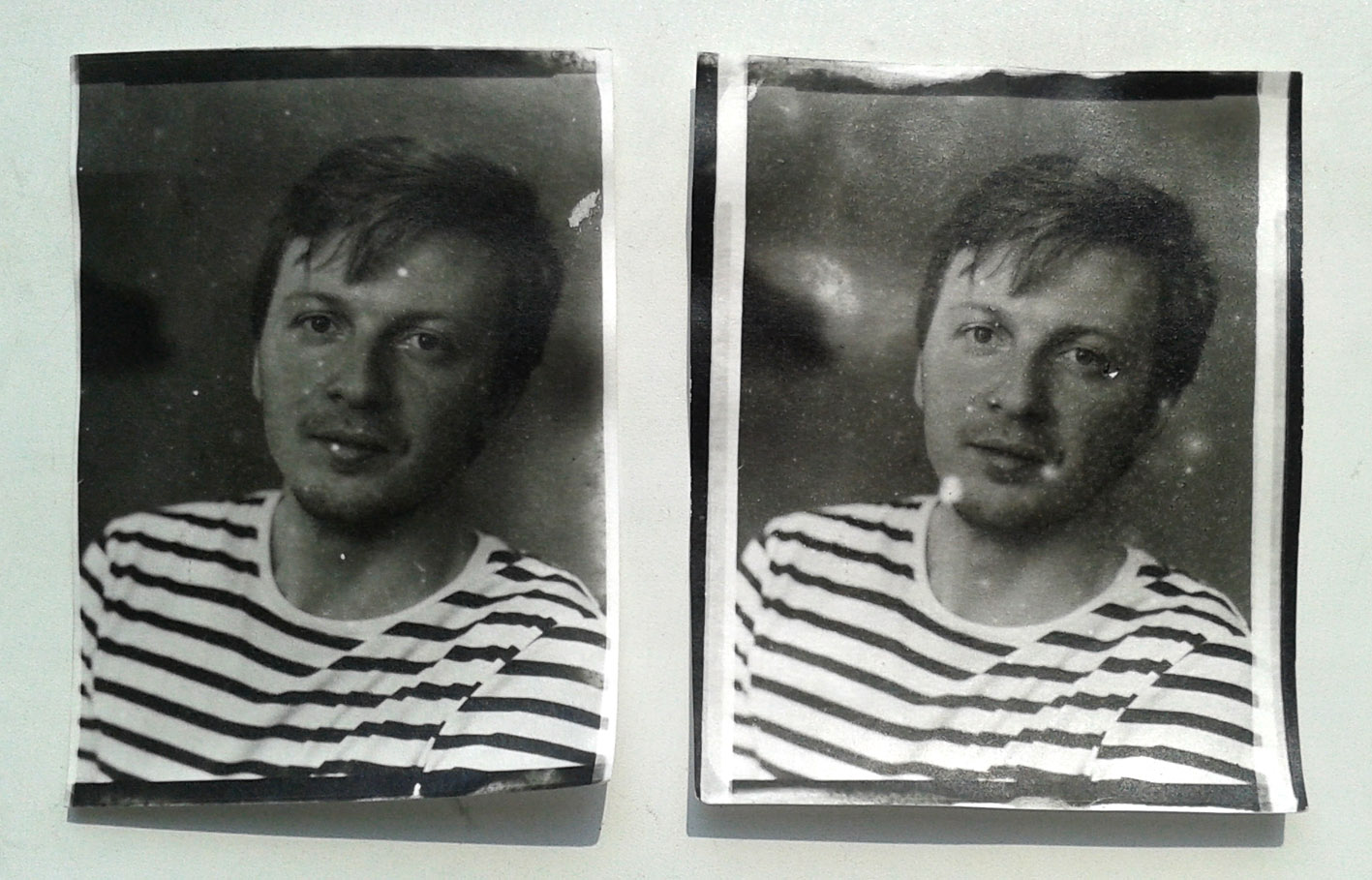

I made a few test prints. Coating additions: glycerol, ethanol and chrom alum.
Unfortunately my coating procedure was not perfect (white dots and 'stars') and I had some problems with uneven hardening and/or adhesion to the watercolor paper support (1 mm 'knolls' appeared during final washing after fixing).

Congrats!
Nice range of densities.
Question: Why the glycerol? It's not usually a final, except rarely with film. Perhaps you meant glyoxal? It's the best hardener for paper emulsions. If you used glycerol, it may be responsible for your repellency spots, rather than the fault of your coating method.
If it's of interest, there's more about repellency spots about 2/3 down this page. http://thelightfarm.com/cgi-bin/htmleditiongen.py?chapter=Chapter4
I mean exactly glycerol (=glycerine). It's a anticurling addition (humectant).
and I used chrome alum as hardener (but plan to use formalin for the some reasons).

I finally made the above emulsion without the addition of extra material. Except for the fact that I somehow got the emulsion dirty it works fine without any addition of material
I coat on fixed out baryta paper and did not add any chrome alum. Had zero frilling...
Seems to be about a grade 2
