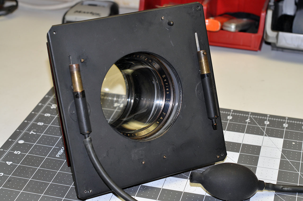

Lens is a Wollensak Velostigmat 15 1/2" soft-focus in a Studio shutter, dating to the 1920's. Diameter of the front of the lens is about 100mm, so I found a #6 Packard shutter with an opening of 4" which is perfect for this lens. The shutter is an older 2-piston design (1947) so no need for a pin to switch between the two settings of 1/20 or B.
Some recommendations about overhauling Packard shutters - painting the outside of the shutter housing is OK, but on the inside get the metal as clean and smooth as possible. I used steel wool to remove all rust on the inside and outside of the housing, spray-painted the outside with Rust-Oleum, then polished all interior surfaces with metal polish and car wax. There's some discoloration of the metal, but it's slick as a baby's butt. The shutter blades were carefully wiped with a clean cloth, but otherwise left dry. The brass pistons were removed and also cleaned with metal polish and car wax. The shutter now fires smoothly.

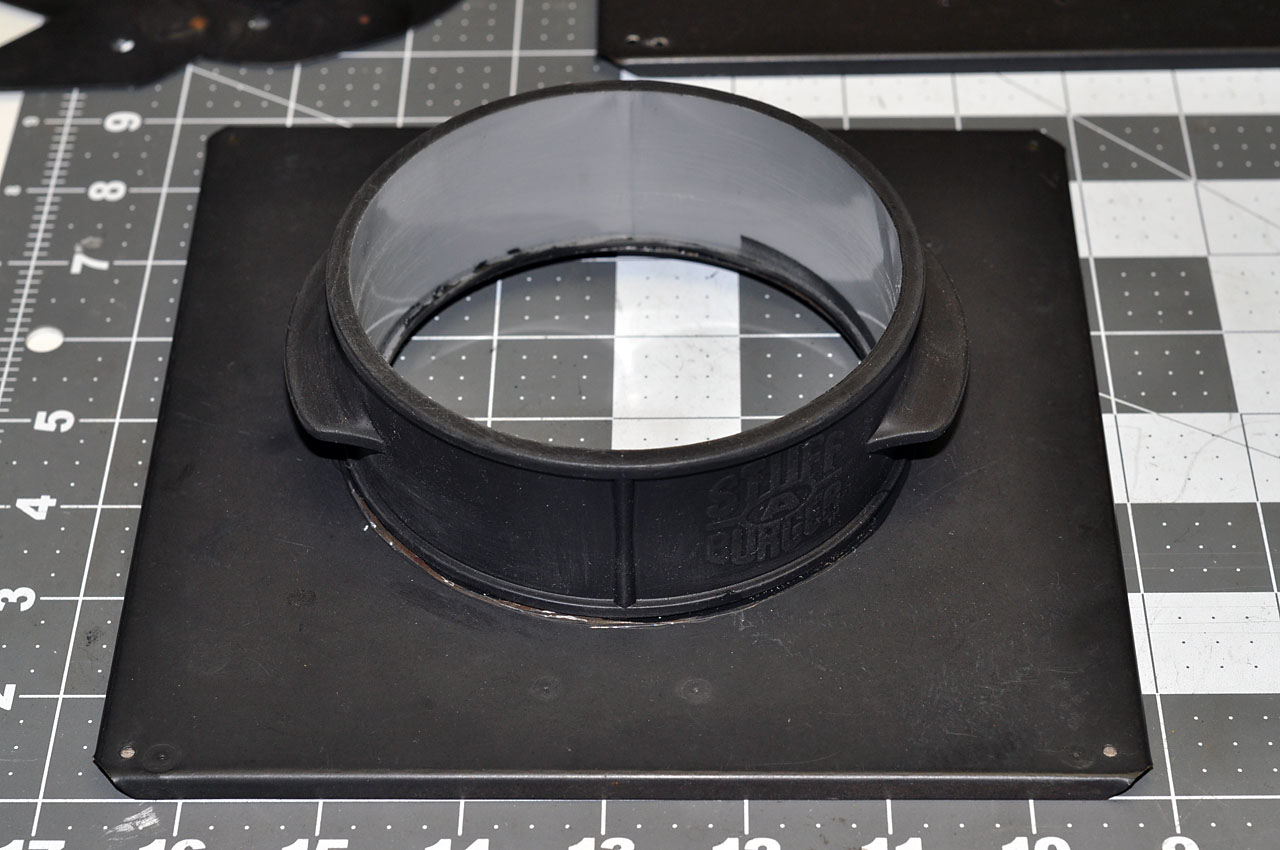

Tried several possibilities from the HVAC and plumbing sections of the hardware store, but nothing was the correct fit to mate the shutter to the lens. Going thru the kitchen drawers I found an old plastic hamburger patty press which was the perfect diameter to press fit over the front of the lens and large enough inside diameter for the shutter opening. Painted black and glued to the rear of the shutter with black silicone sealant. Easy to slide on and off the front of the lens with no play or light leaks.

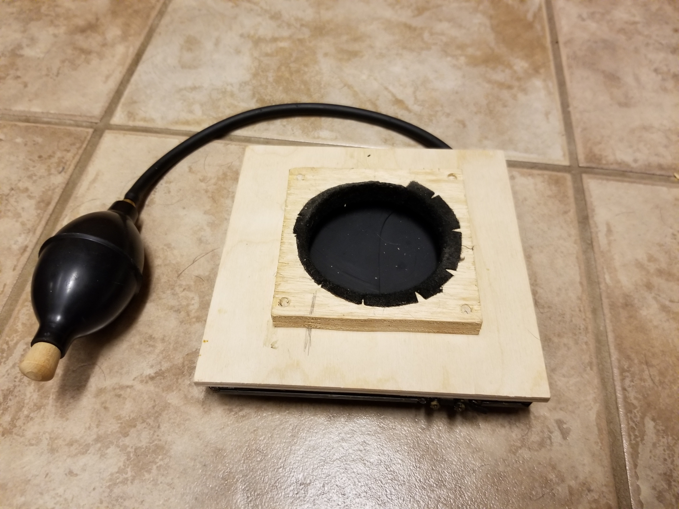

Did mine like this:
The block can be swapped out for other blocks with different hole sizes so I can use the same shutter with multiple lenses.

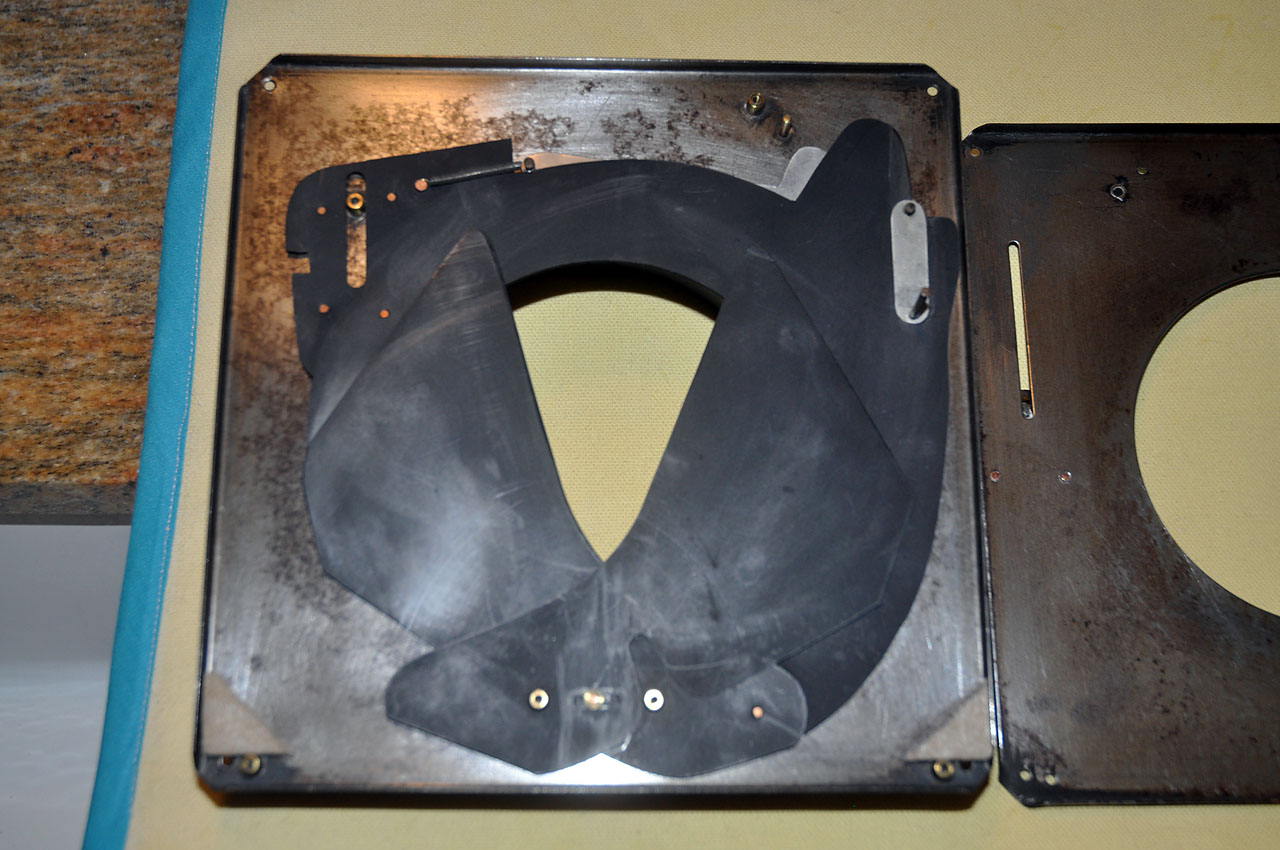

Here is the housing opened with the blades in closed position. 3 thin steel interleaved blades that are driven by the left piston engaging the notch at upper left, or by the right piston engaging with the silver pin at upper right. With this model of shutter, there are separate pistons for B or 1/20 sec. I just move the hose from one to the other piston.
This is the shutter halfway open. As the top black blade is moved up by one or the other piston, the bottom blades pivot outward.
When fully open. If using the left piston for B, the shutter will stay open until you release the bulb to pull the piston back down with negative air pressure. If using the right piston for 1/20 sec (instantaneous), one quick squeeze will open and close the shutter. The silver cam at the top engages with a pin to release the piston back down.

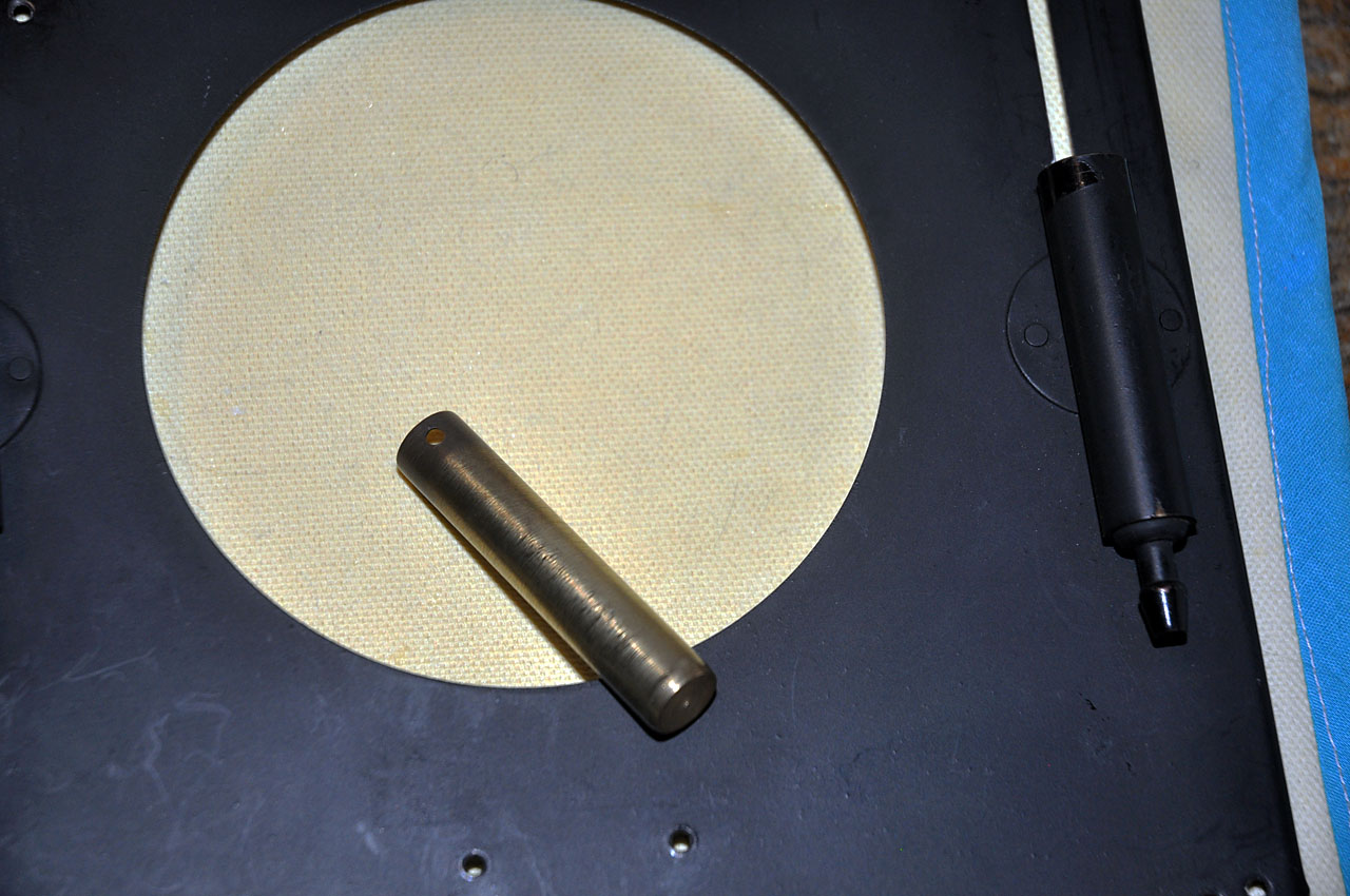

And here's the 1/20 sec piston out of the cylinder. Just a brass tube fitting snugly inside the steel cylinder. Air bulb pressure drives the pistons upwards, so keeping the pistons clean and undamaged makes a big difference in performance. Without the shutter stopping the pistons, they'd probably fly up in the air a few feet.
