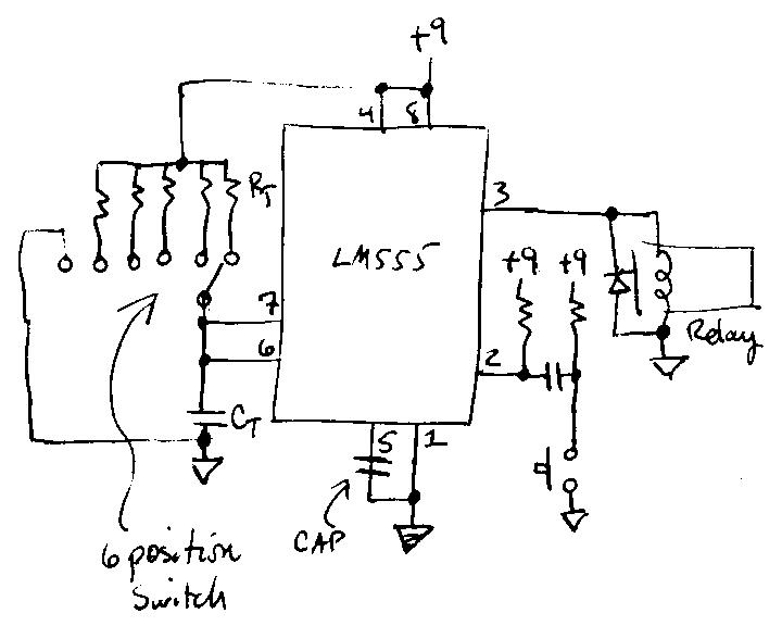

Im looking around to find a packard shutter to modify (to use on my DIY meniscus project). Here's a quick schematic I drew up; I plan on replacing the pneumatic cylinder with an electromechanical solenoid. I still have some math to figure out, but it should work OK. 1/30th might be abit fast (1/15th might be as well...); as I haven't began to look at actuator speeds yet.
Both switches will be actuated by a typical shutter release. S1 is to be used for the 'speed' exposures, whereas S2 is a bulb/focusing switch. It isn't the best way; but my electronic engineering is quite limited.
Thoughts ?
A couple of comments.. S3(the 'bulb' switch?).. will short the LM555 output, which would be low, to your +9Volts. A better way might be add a throw to S2, and make a bulb setting, and trigger it with S1 as you would your normal 'speeds'. The other thing is your timing resistors seem to be set up in a mix between what is normally done as the one shot mode and the oscillator mode. I'm sure you can make it work, but the normal design equations won't give you the right values. Good luck with the lens and the shutter timer!

Jon,
Ah, thanks for pointing that out. An idea that wasn't thought out - obviously.
I was going to try the design out tonight; but I cannot manage to find my breadboard. I then learned that RadioShack no longer carries such items !?
I need to do some more research on the 555 to make sure I have it right; which it doesn't seem I do :D
Thanks,

Well.. I scanned a sketch of what I was thinking, but before that - Jim Galli had a very good idea. If the shutter you can buy will do what you want, and i think with some disassembly and duct tape it might work. What I sketched should work - I'm sure of all but the bulb setting, and it should work. There are differences between what I sketched and what you have - the changes in the switch placement, diode and extra resistor are on purpose. If you want to continue here, or pm, I'd be happy to help out if I can.

Jon,
Thanks for taking the time to help me out. I found the issues you pointed out late last night; and made my corrections. Hopefully I can fibd a breadboard and give 'em a whirl.

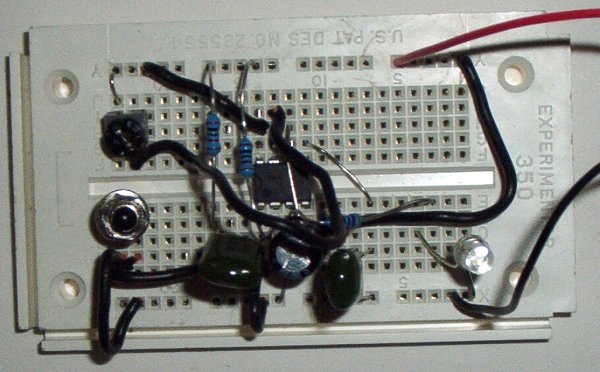

I just completed building the circuit (although I haven't completed the pot bank), and it works flawlessly. Im going to be taking it off of the breadboard and soldering it up later this evening.
I'll post pics then.
Thanks again to everyone for your help !

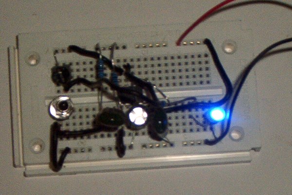

Some quick shots before I transfer it over.
