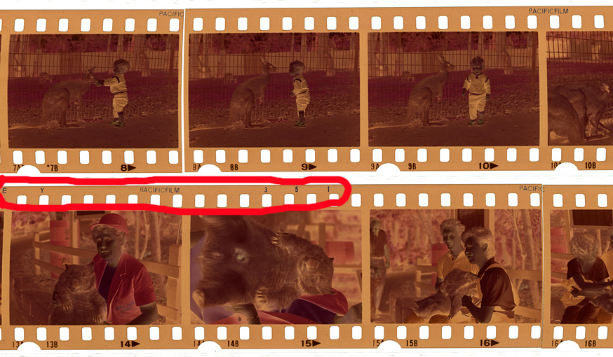

I'm working on scanning all my colour film negatives from 1979. Reached 1985 and can't recognise this film. I was a bit stretched financially at the time and recall often buying the cheapest film around from the pharmacy or supermarket in Sydney. I also have a memory of some outlets giving you a "free replacement film" which was rarely a major name brand - maybe in a red box? I've tried googling but can't seem to locate any information about PACIFICFILM. I presume it was a rebadged film. Fuji or Agfa perhaps? Anyone else with a long memory or recollections of this film? Cheers, Tony

Pacific was a big lab based at St Leonards. They did all the processing of film left at chemist shops, same day turnaround, just before minilabs came along. It was connected to Hanimex in some way, perhaps owned by the same guy. So it would have been rebranded Kodak, Agfa or Fuji as you speculate. I wonder if any of them manufactured film in Australia in that era?

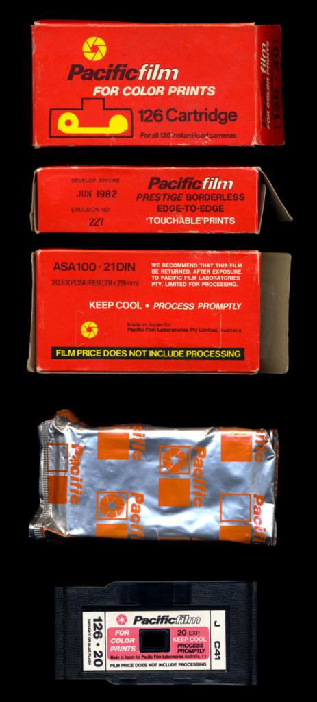

Hi Tony,
I have a 126 Cartridge and all of its packaging from PacificFilm. The box and cartridge read "Made in Japan for Pacific Film Laboratories Australia". I'm happy to scan the packaging for you if you'd like to have a copy for future reference and a trip down memory lane. :smile:

I got sample of Sacuracolor of that period, yielding the the same lettertypes on both edges, though I can't see whether that sample has got that arrow too.

Thanks Michael. Hanimex is another name that has all but disappeared. The site below says it is now linked to Fujifilm, so maybe it was re-badged Fuji per Molli's post indicating it was made in Japan.

Based on the scans of about 5 different types of film so far this Pacific film has held up pretty well. Kodak is probably the best in terms of colour fading and ageing artefacts. Some rolls of Fuji NR 400 film has aged and discoloured quite badly but hard to know how much is due to underlying film quality vs processing quality? My memory is that 400ISO colour negative film of that era did not have a great reputation.

Here are photos of the packaging and 126 cartridge for you, Tony:

Ah, the red box. I can have some faith in my memory after all! I suspect this was the free replacement film from the local chemist at the time. Thanks Molli.

Pacific Film Laboratories was a company started by Neil Cottee and Harold Jefferies at Kogarah in Sydney. They aquired a number of other photo finishers which also gave them a plant at St Leonards. They had branches in all Capital Cities including Canberra. They were the first company allowed to have Kodak Film repackaged to bear their name 'Pacific Film' this was manufactured in Melbourne I believe. They also repackaged Fuji Film later on.
I worked for Pacific Film Labs from 1974 till !985.
They moved from the Kogarah lab some time before 1974 to an old Picture Theatre site at Carlton. They were a big user of equipment from both Gretag is Switzerland and CX laboratories in USA. They used cutting edge equipment often to the point of having the protopype or first production machines in the world. While I worked there we often supplied updates or improvements to these manufactures only to see these updates or improvement return to us as improvement Kits a few months later. Our quality was very good and we had much equipment manufactured in house. All chemical baths had locally designed and produced temperature controllers and inline heaters. We aimed for 100% quality and local supply where possible.
The company also employed a large number of sight impaired people. They worked in the dark rooms handling customer film and preparing it for processing.
