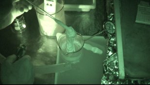

Well, PA gelatin takes a long time to coagulate unless used alone with no other gelatin. This is not normal but can be used in teaching situations until the student "sees the light". This is in my book and dvd set both with visual examples.
1. Slowly reduce temperature and pH. Temp to about 30C and pH to about 4.5
2. Coagulum should form and stick to stirring rod.
3. Wash coagulum
4. Redisperse by heat to 40C and pH rise to about 6.5.
The attached photo shows an example of the coagulum from the DVD when it is cold and acidic.
PE

What you propose is quite reasonable but difficult for a beginner, and that is why I give the instructions the way I do.
A coagulum as you describe your procedure may take hours to form depending on conditions (concentration, temp, pH and etc.).
A coagulum as I have described takes place instantly as you cool and acidify. It becomes tacky like chewing gum and that is it. You can actually lift out the ball of "gum" and squeeze it. With the other method, which is more normal, the coagulum is not a single chunk, but rather, it is a group of chunks or a flocculant.
