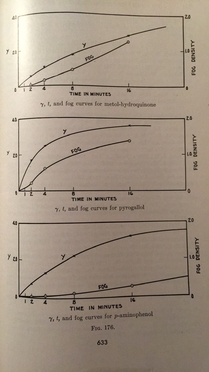

I am interested in trying a p-aminophenol developer after seeing a chart in Mees showing low fog density.
I am considering using it to improve the results that I am getting from old (1952-expired) Super-XX 35mm.
In standard Metol-Hydroquinone developers (tried stock, cold D-76 and Dektol with and without Benzotriazole) the fog is high 0.96, CI is low about 0.30 and EI is low - about 2.
Are there standard or well-known developers based on p-aminophenol that I should consider?

This is the graph that caught my attention...

@Bill Burk please note, that these three curve plots were made for a specific set of photographic developer formulas. Any variation to these developer formulas will change the chart, You know well, that there are MQ developers with very different contrast, and the contrasty ones are not necessarily foggy.
