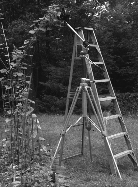

In smaller formats one can find horizontal columns (sometimes part of the tripod system) to hang a camera off to the side, but I'm not sure there is such a rig up to handling a 4x5 monorail! The first thought that popped into what's left of my mind was 'use a mirror' but you would still need a way to hold it, and especially if it's a normal 2nd surface mirror, there might be some optical compromises.
How about a super clamp gizmo on the side of a stepladder?
(OK, I'll go back to my coffee) Good luck!

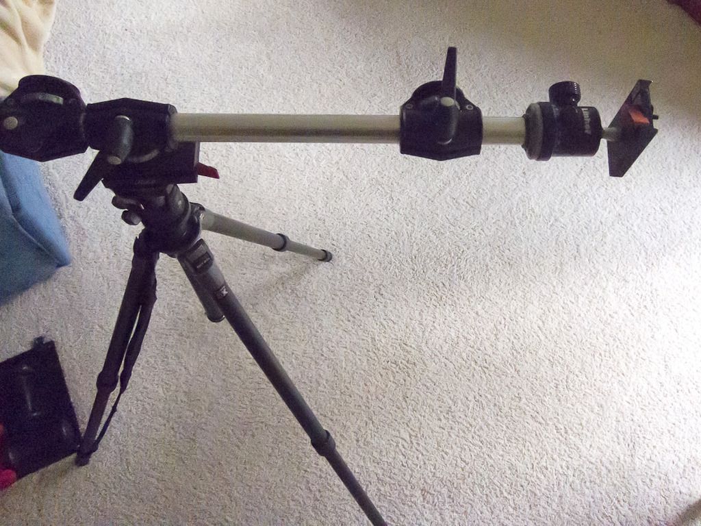

Here is the Manfrotto horizontal arm mounted on the top of my Gitzo 25xx only for illustration. Center of column to top of Linhof baseplate in this photo is 21". You need to be sure that you have a VERY heavy tripod, so that the entire thing does not tilt due to the weight of a monorail camera + lens!!! I have a Bogen 3036 tripod which weighs about 15 lbs. so it is just enough to counterbalance that weight of my Horseman 45LS mainframe, but I would hang more weight on the tripod itself to make for a safer configuration!

A bit of an update- After yesterday's posts I left Job 1 and stopped by a local camera shop that sells used gear to kill time before Job 2. Found a great SB26 Nikon flash that replaces the one I previously had which died a horrible and painful death, lol. While there I mentioned the Manfrotto/Bogen double camera arm. Used equipment/intake tech comes from the back saying "I thought we had something like that around here...is this is?!?" BOOM- exactly as described in the post, what I looked up on B&H, and what I was wanting to order through the Manfrotto rep was now before me and available for a song- $30 out the door. I'm setting up in the studio this weekend and will FINALLY get this series started. (it's been on the books for over a year, I've just gotten stuck due to the aforementioned tech issues for this particular shot....)

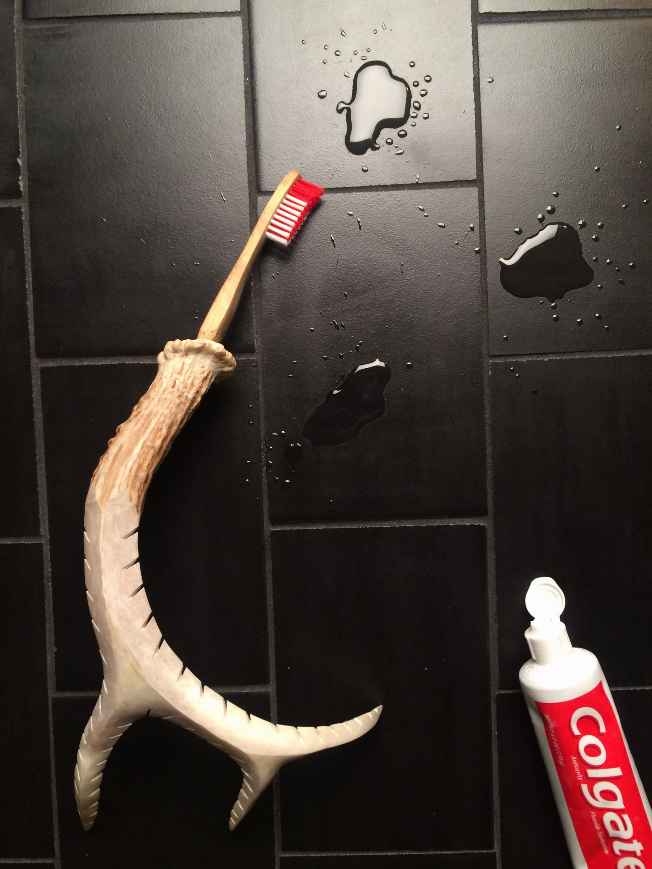

Here is an approximation of what things will eventually look like. This is a cell phone snap of the set using just the modeling lights. Its an ok approximation, but I am unsure about the exact crop as the film has not come back from the lab yet. I've torn this one down and will be building another soon with a different lay out, not as tableaux like, but still using the black tile board in the background.
Thank you all, again for the advice and insight.
All the best-
