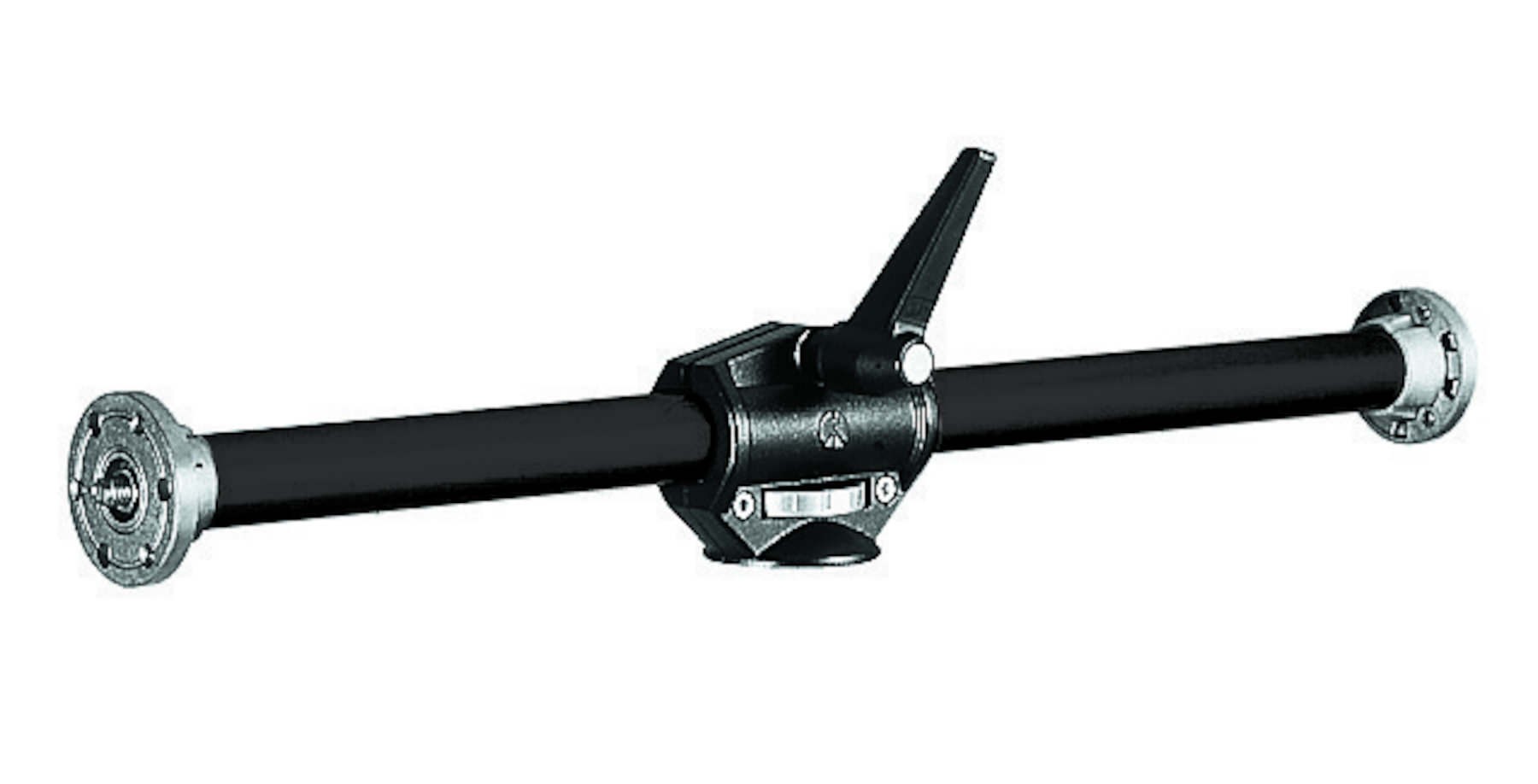

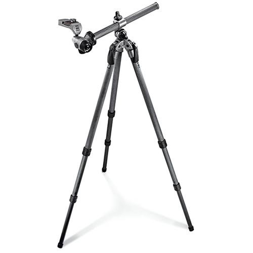

If the subject is not too big and your camera is not too heavy or bulky (4x5, motorized 2-1/4), a horizontal arm can be used with your tripod and a counterweight. You might be able to locate a Gitzo Explorer that has a rotating arm instead of a center post. Another thought is a copy stand on a table with the camera support or post rotated so you can shoot something on the floor.
