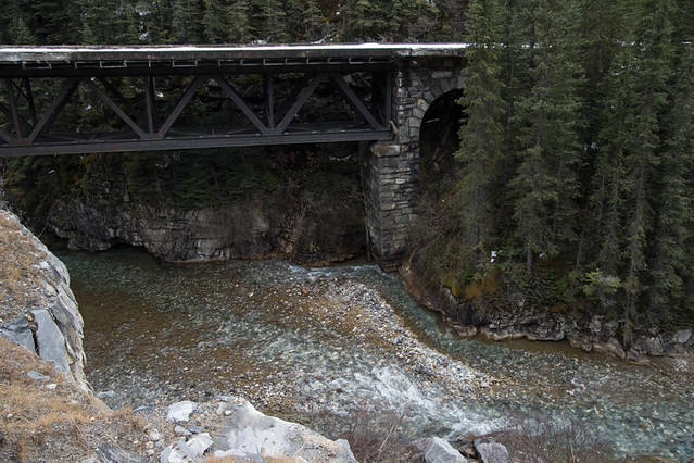

I ran the negatives tonight, and they look good. A little darker than I would normally develop to, but a full range of tones and good shadow detail without the highlights being baked. At least that's my impression from holding them up as they came out of the wash, I have not tried printing one, but I think they will print well.
I shot it with my digital camera as well, this is the scene:
On the negatives I have preserved the detail in the trees behind the bridge, and under the stone arch.
