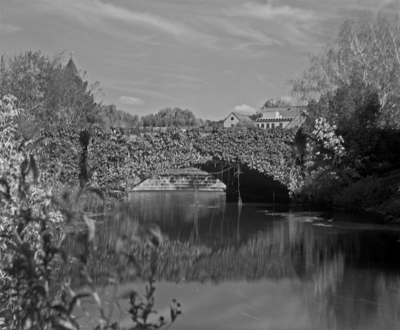

OK: Here is the result for that overexposed negative:
OK The details: As follows:
FP-4 rated at ISO 50 shot thru a red filter 3x Metered and for F-22 got a 15 seconds exposure and no reciprocity included !
The lens used was a Planatograph lens by Baush & Lomb century shutter about 1900 vintage :
Developed in ID-11 at 68 degrees in a dilution of 1-3 for a total of Nine minutes
Scanned on a epson scanner at school and the only correction s were highlights and contrast ?
