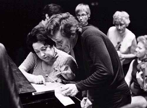

This example is a photo of Alicia De Larochs, pianist, discussing a point of interpretaion with Russell Stanger, conductor of the Norfolk Symphony (Which has since become the Virginia Symphony) during a rehearsal in 1967. I took it from my position as principal oboist during a break in the dress rehearsal on Tri-X, 1/60 @ 2.8.

Her name (may she rest in peace) was De Larocha.

Gainer, where have I seen that photo before? Is it published?
*I found it :smile:
*I found it :smile:
Yes, I had posted it before. I made a print for her and presented it to her the next day at the concert, and she autographed my copy. She was a gracious lady with very small hands for such a gifted pianist. The Hispanic combination of fire and love showed in her playing.
