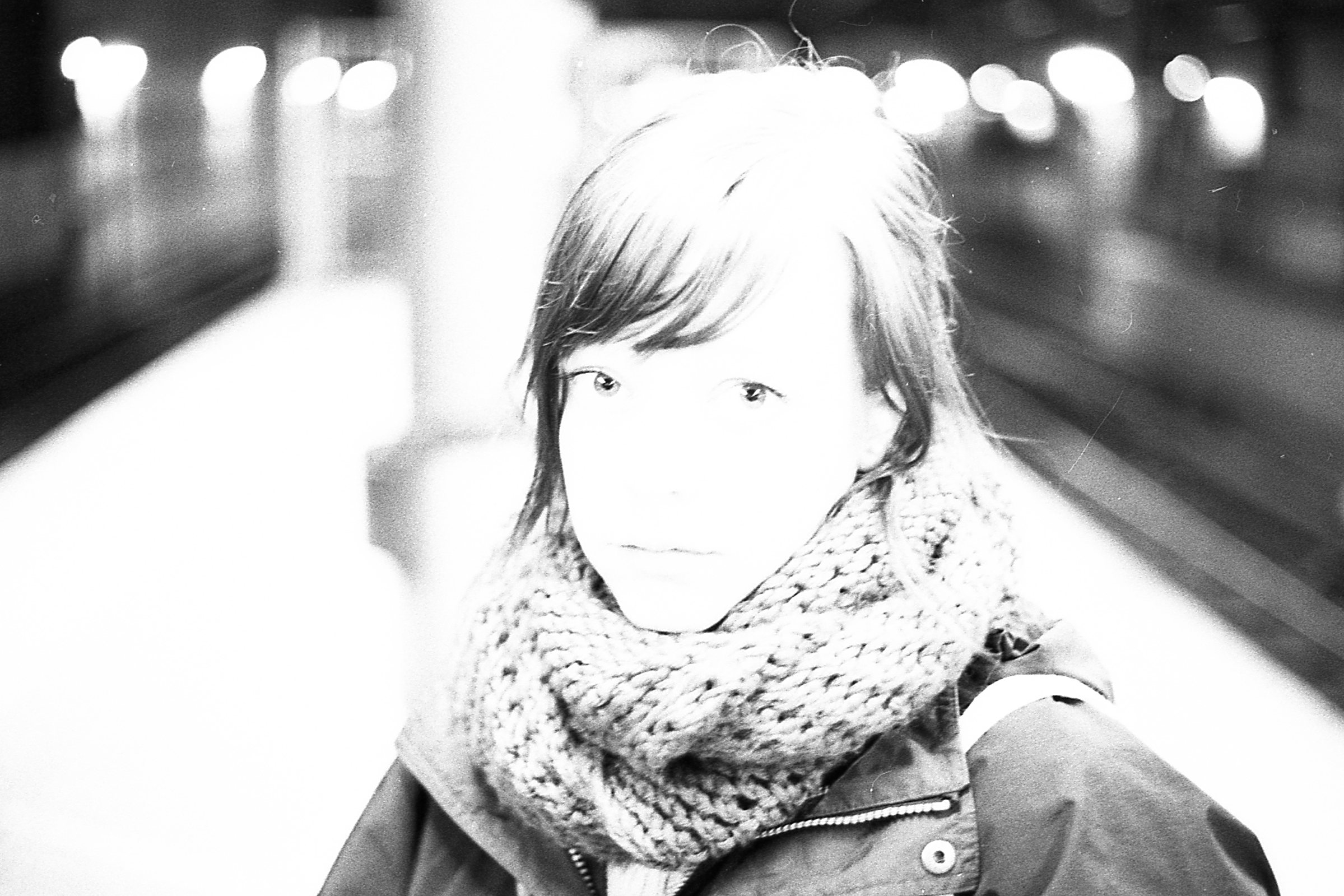

if you've got multicontrast paper, might be able to save them by using a really low contrast filter in the enlarger. Just a suggestion, but if you're pulling detail out of the highlights in the scan, I think you could work a bit of darkroom magic on them and get pretty decent prints out of them after some trial and error
You have pretty normal looking shadow detail, which means you didn't over-expose them.
The negatives are over-developed, verified by the extremely high density in the highlights.
Dektol isn't necessarily a bad film developer. You just have to watch it carefully so you don't over-develop. Try different shorter developing times, and I'm sure you will find a good compromise.
It is grainier than D76 for sure, but with modern films that could be a benefit.

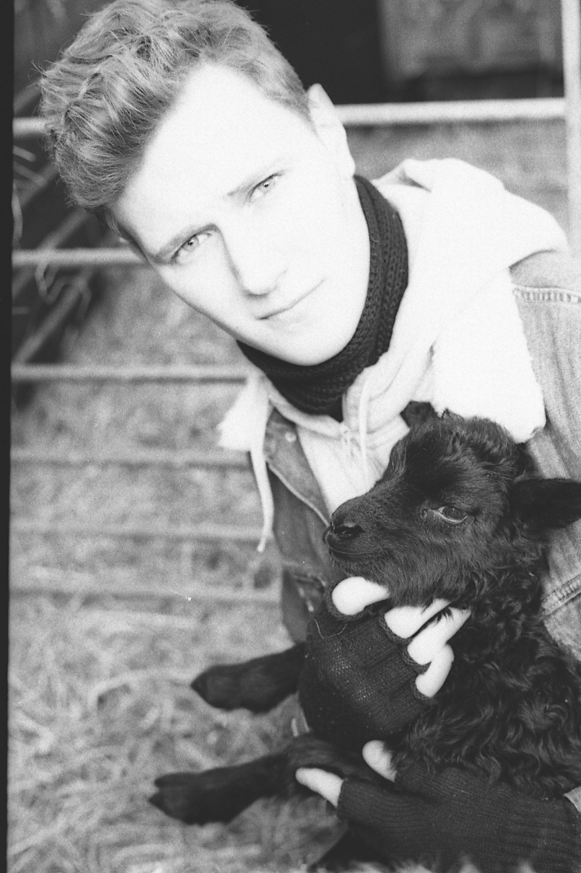

Hello. Im quite new to developing myself and i cant get my head around this one!
I developed three rolls of tri x 400 yesterday. They came out really really bright!
Heres two examples (one from each roll, developed differently)
48791-overdeveloped-overexposed-tri-x400-d-76-img153.jpg.att
48792-overdeveloped-overexposed-tri-x400-d-76-img183.jpg.att
Im 99% sure my cameras expose right. Ive shot these pictures with two different Olympus Om2.

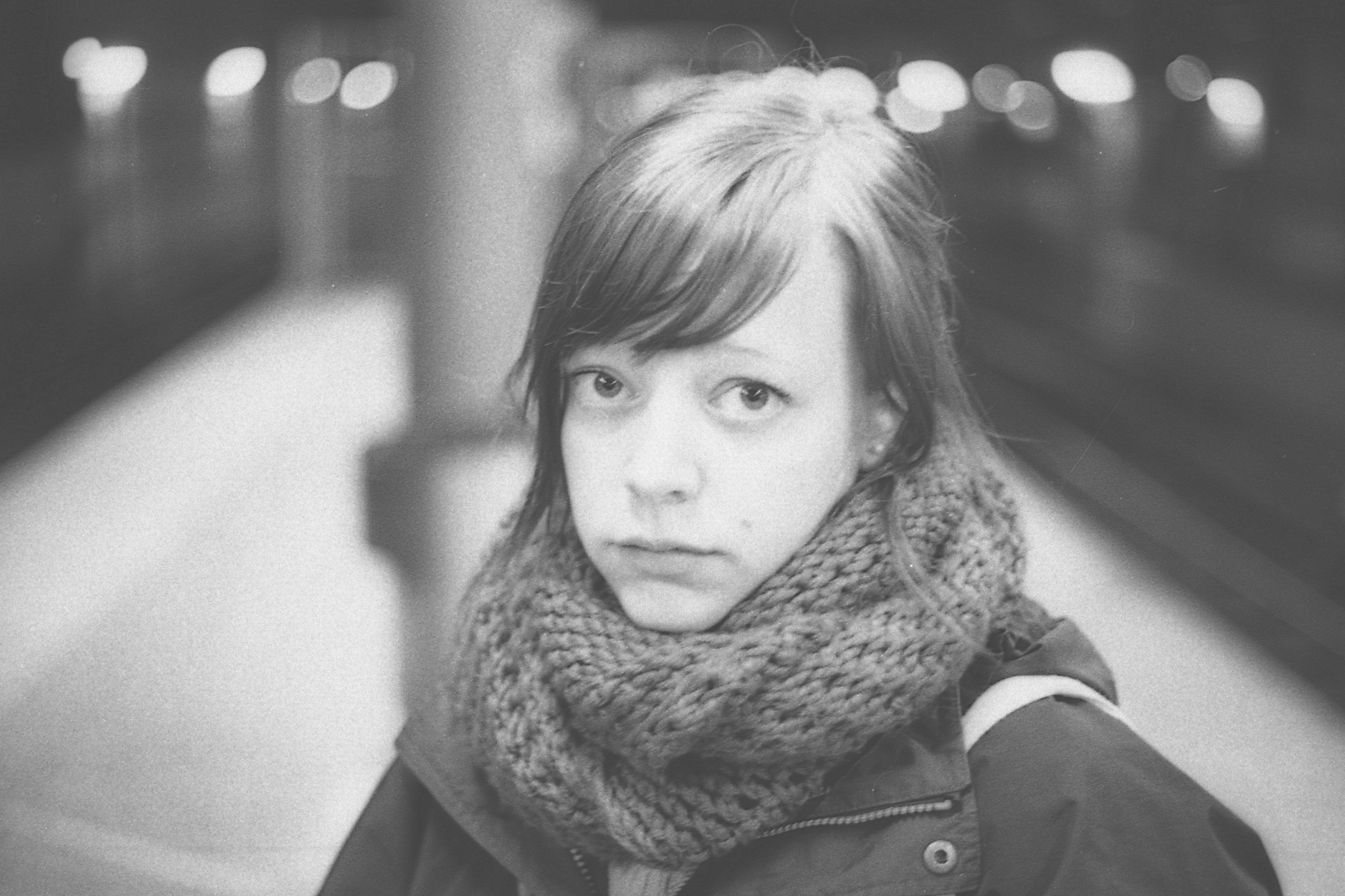

I did manage to "save" them by reducing light and contrast in the scanning process.
Example:
48793-overdeveloped-overexposed-tri-x400-d-76-img164.jpg.att
48794-overdeveloped-overexposed-tri-x400-d-76-img189.jpg.att
They look really bad and boring but i do get the details out? Isnt that a sign of overdeveloping. Shouldnt it be all burnt out if it was overexposed?
