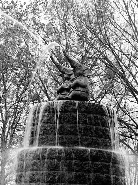

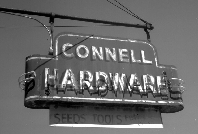

I tried a few sheets of 4x5 with HP5+ and XTOL, and the results do look promising. These photos are not much by themselves, just for testing purpose, and yes, they are scans, but this is totally for illustration purpose. Check the linked article to see the author's darkroom prints.
Oh, I was also using swing to show off view camera capability of getting more things in focus despite using a 150mm lens at F5.6 ("equivalent" to 40mm at F1.5 or thereabout), and using a soft focus lens at that to show off some blooming effect.

Can you say by how many stops these negs were overexposed and overdeveloped? Is it as per Mr Patience's method of 2 stops over exposed and one stop over develop? If this is the case and if the scan of the second negative especially is a replica of such a process then it does not look like 2 over in exposure and 1 over in development. However if this is the negative achieved and a print of the scan will be as per the scan then in your case this looks like a reasonable process.
I am not a scanner and I do have some scepticism about whether the scanning route give a true reflection of what a printable negative should be

For both images shown, I spot metered the dark areas so they would be around zone III or so, and place them in Zone V. The side of the building one was mostly shaded light so lower contrast whereas the other one was in full (California) sun so reasonable high contrast if you at the dark areas comparing to the sky. I think @Nokton48 said it: the goal is have a dense or "beefy" negative.
