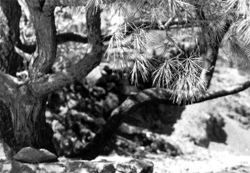

looking through older negatives & prints, i realy don't think it's my processing at fault. Excellent info on the jobo though - mine is the older version.
I think the problem actually is... cheap filters.
Most of my shots in Greece were taken with a Jessops Circular Polariser, and a lot of my landscape shots before those were taken with a Hoya Orange filter. Im still convinced that my camera may have been giving false readings though - as most of my Santorini negatives are unusualy dense, particularly the last couple of rolls. Im yet to develop the final one.
Attached is a full frame print, and a section from a 16" wide print. One of the few shots without the Polariser - sharpness seems prety good, with none of the loss of edge definition shown on most other shots.
Jim
