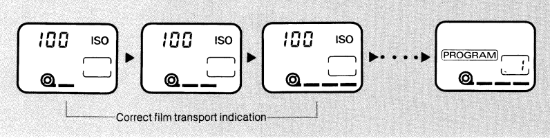

That I considered a unloaded T70 as loaded and did not realize the cassette icon missing is one thing, but that the automatic film-take-up would not work properly surprises me.
Yes, then one likely has to check that ikon for this too. Unless we see the cassette and 3 strips, something is wrong.
BUT one does not need to look for the strips adding up, just looking after loading for the full 3 strips icon is sufficient.

There is a question of timing: you just released the shutter, and in an instant, the display would show the motorized film advance bar.
I am new to this model, so I need to practice with a old test roll and observe carefully, and trust the display.
