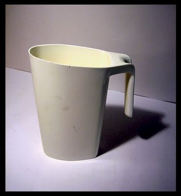

Tray is most versatile for any sheet size, but for the last year or so I've been using plastic milk pitchers (for milk bags sold here) for 4x5. See stolen photo attached. Obviously similar juice containers would work equally well.
Advantages include being cheap, easy to load, wide mouth for filling, just the right height and width for 4x5, bowed so film doesn't touch/stick to the sides, easy to pour chems out for reuse, takes far less space than trays, three can go into a flat-bottomed sink or paper tray for drips, etc.
I use 3, and load up to 6 or 8 sheets (one at a time), and then shuffle from back to front. Shuffling is much more gentle and easier to do than shuffling horizontally in a tray. I've done maybe 300 sheets this way, and have never had a mishap with either incomplete development or scratches or suchlike.
