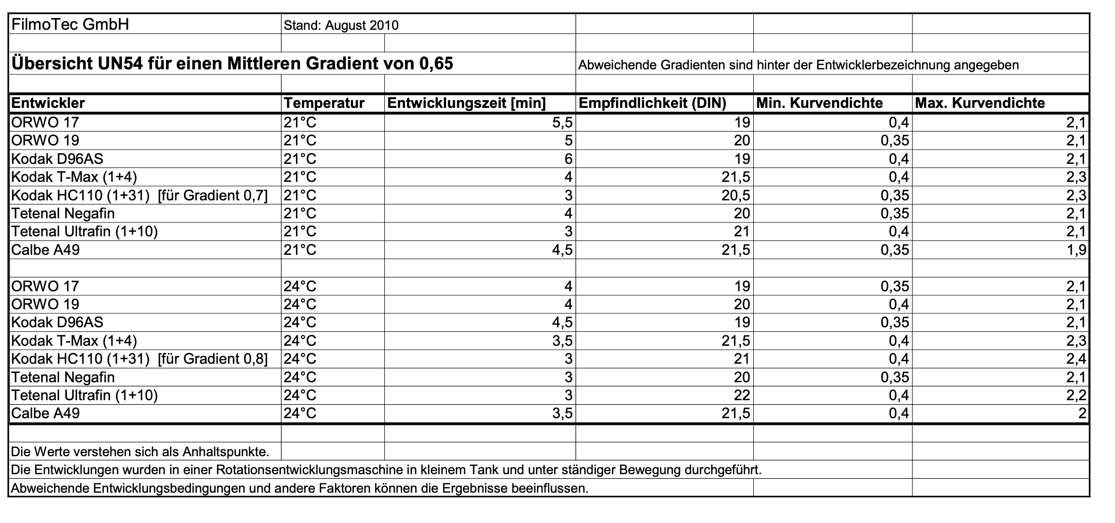

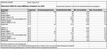

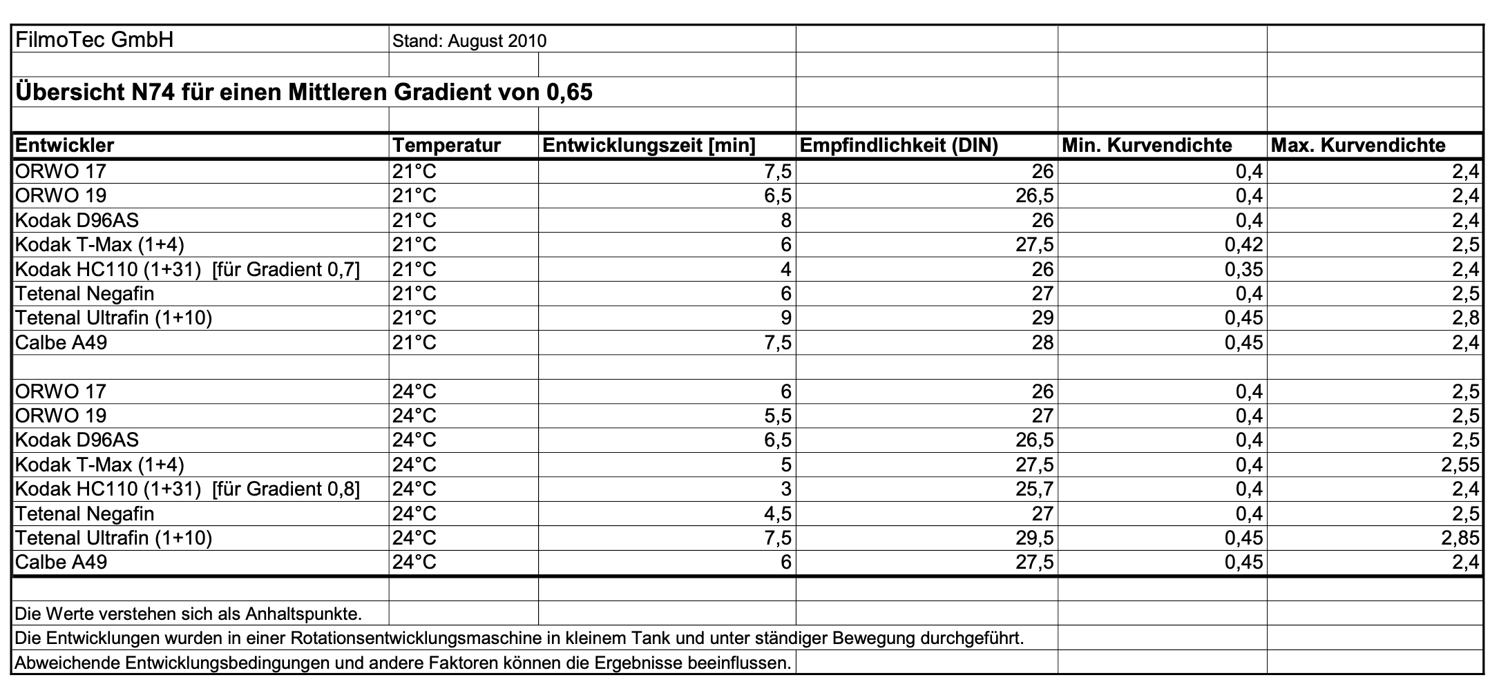

hello friends could you tell me in xtol the developement time??
thanks
subsole
Feb 5, 2008
143
Lower Saxony
