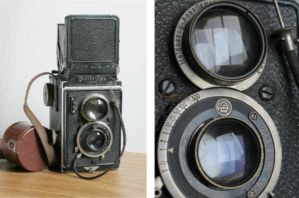

I just picked up an original model Rolleiflex (thrift store find), seems to be a model 614 due to the film back being hinged and the taking lens being an f/3.8 Tessar.
Anybody using one of these regularly? Sample images are pretty hard to find in my searching so far. I've got an Ikonta 532/16 with the uncoated f/2.8 Tessar...are the results going to look pretty similar?
Here's a photo of it as it sits right now after 50 cotton swabs worth of grime removal.

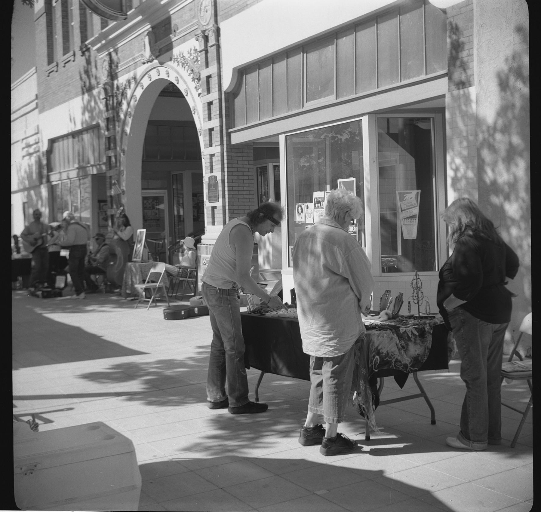

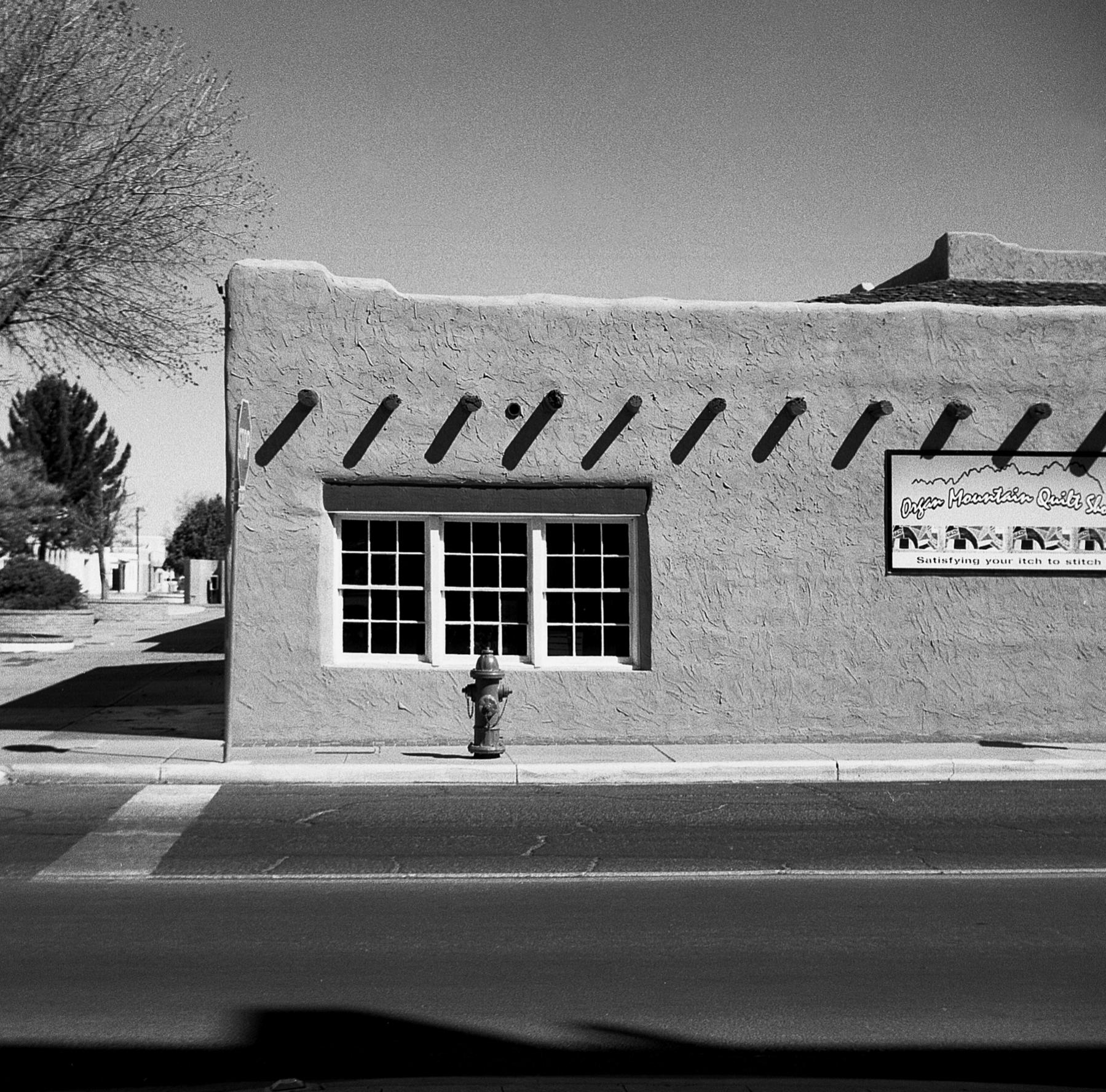

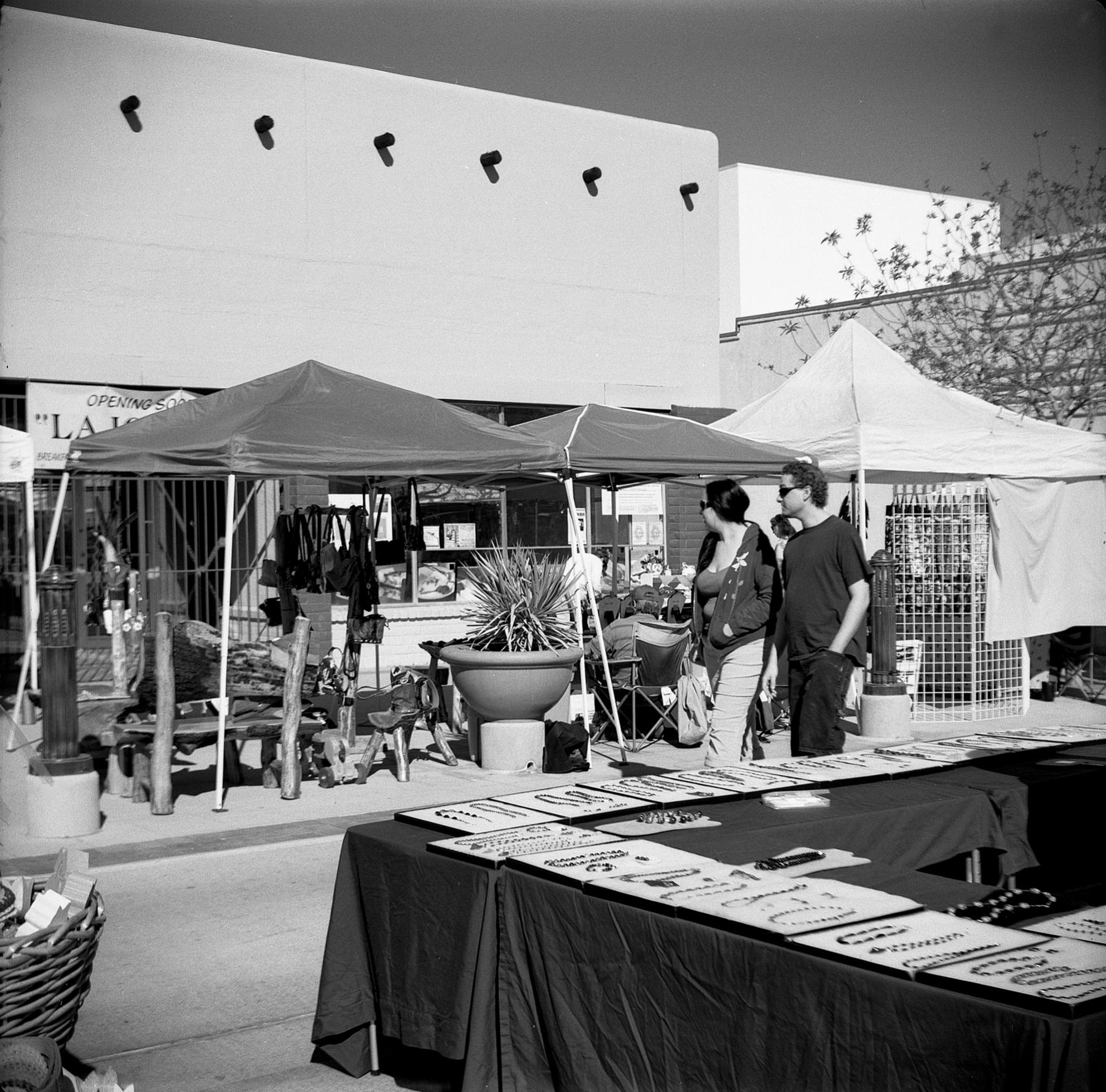

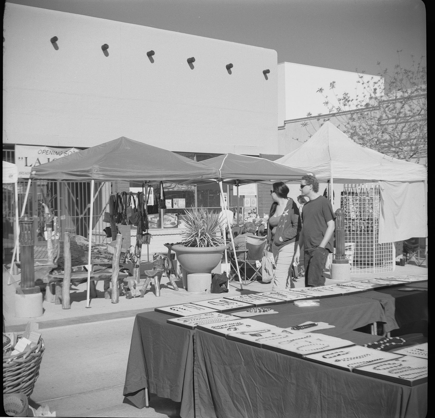

These are from the Rolleiflex Standard that I owned w/ the 3.5 Tessar and Tri-X. Yours should image similarly. Expect very low contrast and the usual Tessar signature. Mine also had quite a bit of light falloff in the corners. I had to bump the contrast up quite a bit, even though these were shot w/ a yellow filter in contrasty, noon New Mexico sun, so there's Before and After shown below. The 2 shots in the middle are w/ no contrast bump. Fun little cameras!
I actually prefer the Triotar lenses to the Tessars. They're very sharp in the center (sharper than the Tessar), softish in the corners until you get to f16, and in my opinion, one of the best portrait lenses you can buy.

Excellent, thanks all for chiming in. The shutter will need a cleaning. I got the front lens element off to get at the shutter blades and they are clean and dry so it's an internal shutter issue slowing things down. Looks like the leather(ette?) doesn't need to come off to get inside there, less to fuss with and more to keep original.
That being said, I'll likely put new mirrors in it to brighten things up as I'd like to use it a bit but will see after I get the ground glass cleaned up if that needs replacing as well.
Compared to my girlfriend's Rolleicord Va, I'm surprised how very light the metal parts are...no wonder the hood was all bent up on it when I found it, super thin gauge through and through.

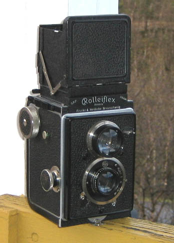

My camera:

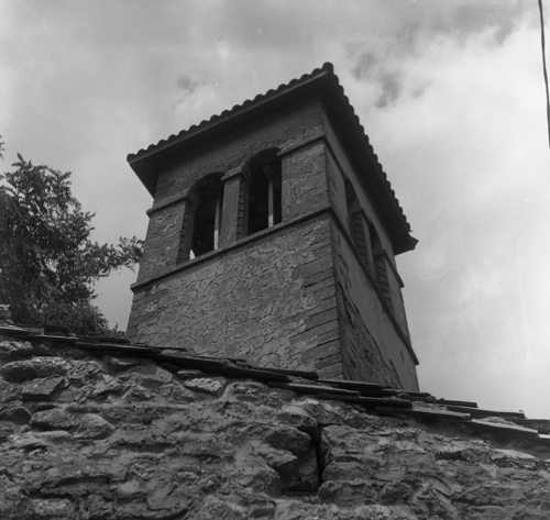

I have some 620 films spooled off 120 (it's impossible to use too big 120 reel with the Original). I only used one film because the results were not perfect...
However lenses are coated (blue) on the camera I used ; I suppose they were after ww II.
I have 10 working Original's and some others to repair : I think it is not the best camera to take pictures...
Here are one from this camera and others of it (it's a 614) ; it was also modified with a flash sync :

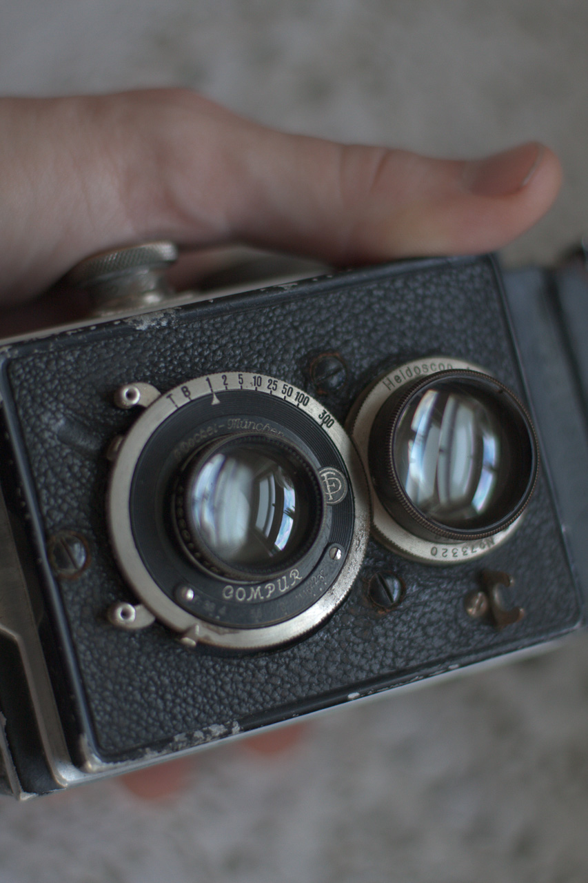

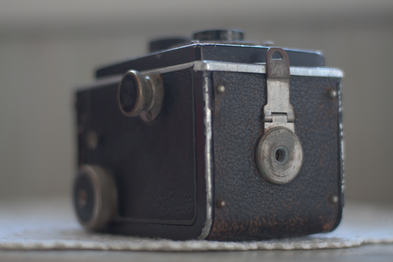

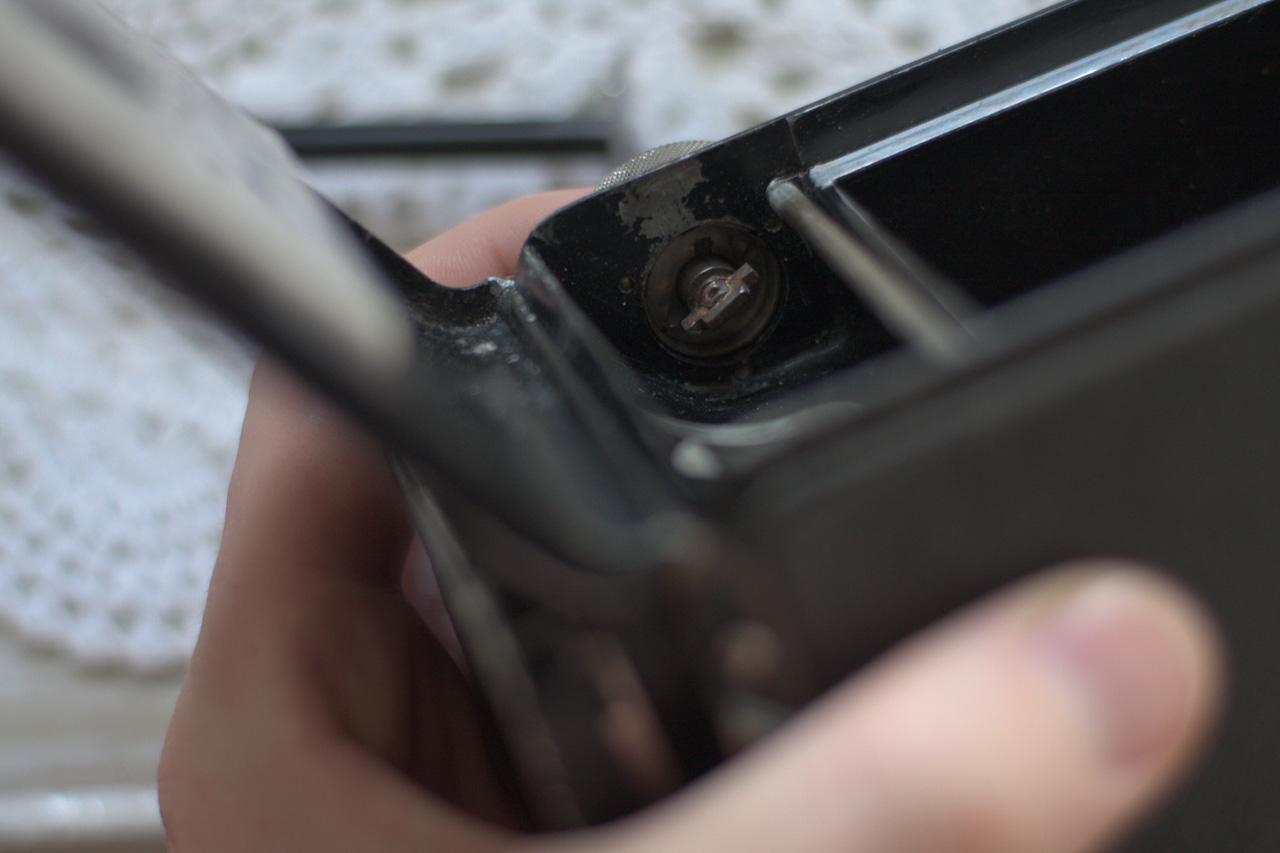

So finally got around to opening up the Compur on this one. Bit of cleaning and (very light) lubing later, she runs on all speeds and happily. The lenses cleaned up easily and have a few light cleaning swirls but no haze stuck around and no fungus damage.
The mirror is clearly due for replacement, I may also replace the mirror in the hood while I'm at it but it's unlikely I will ever use the sports finder so I may pass on that replacement. Ground glass cleaned up nicely, still pretty dim but better and mirror should help that as well. The built-in level is a neat little feature! Focus is now lubed and much smoother.
I also spent some time straightening up and fixing the mechanisms in the hood/magnifier so that all works properly and snaps open/shut smoothly. The only portion of the hood that was too damaged to completely fix was the magnifier panel which seems to have some sort of latch to hold it into vertical position but this doesn't latch and so can rotate into/out of place depending on the position of the camera.
Similar jobs were done on the rear door which didn't latch properly at all, after some work it closes properly so really the only thing left now is to try a test roll of 620 and see what it looks like.

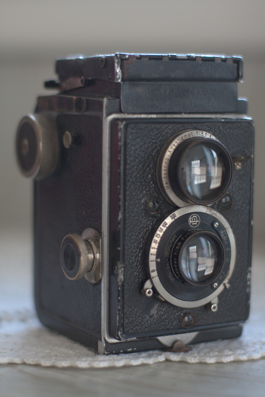

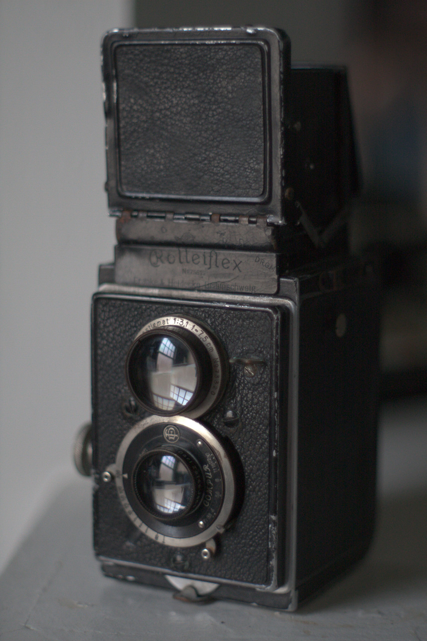

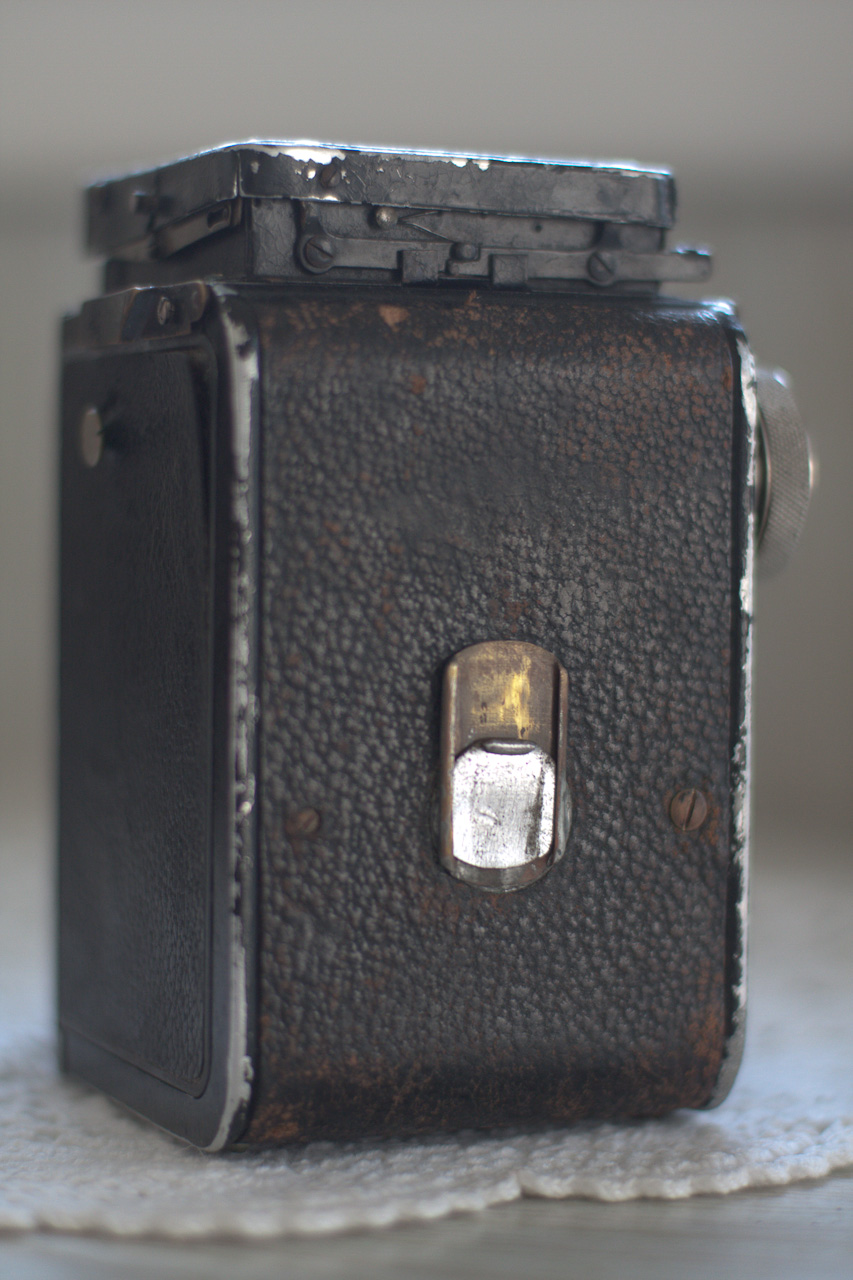

Here's a pictorial update to go with what I previously posted in text. Still some basic cleaning to do but I'm not interested in refinishing anything on it. Been a fun process to go through, enough that I bought a cheap slightly later model 'Flex on the 'Bay to do it again.
